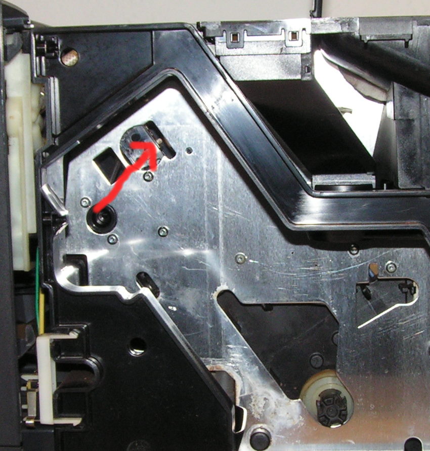

Hi there,
First off, I'm so sorry that I don't know German. I really hope you can accept me anyway.
My problem is, I have a Siemens Surpresso TK54001 which started a few months ago blinking as if the brewing module was not inserted. I called Siemens and they told me what the problem was, it was the switch inside that started to give up. Alright, so I went in and replaced it and it worked perfectly since.
Until two weeks ago when I hit another problem. When I either turn power on or insert the power cable into the wall I get; Power button flashes on/off together with the coffee dispenser button. I can't find any troubleshooting info anywhere telling me what this error is and when I called Siemens they just tell me that I need to have it serviced. They refuse to say what the problem is at all.
Also, it was impossible to remove the brewing unit because it had stopped in the middle of it's moving path. (half-way up to the water dispenser).
I figured that perhaps it was the other two switches that senses in what position the the brewing unit is, so I changed those two as well, but still the same error.
Any idea on what it could be? Please help me out, I'm really desperate, but not desperate enough to pay Siemens for something I probably can do myself

Hi there,
