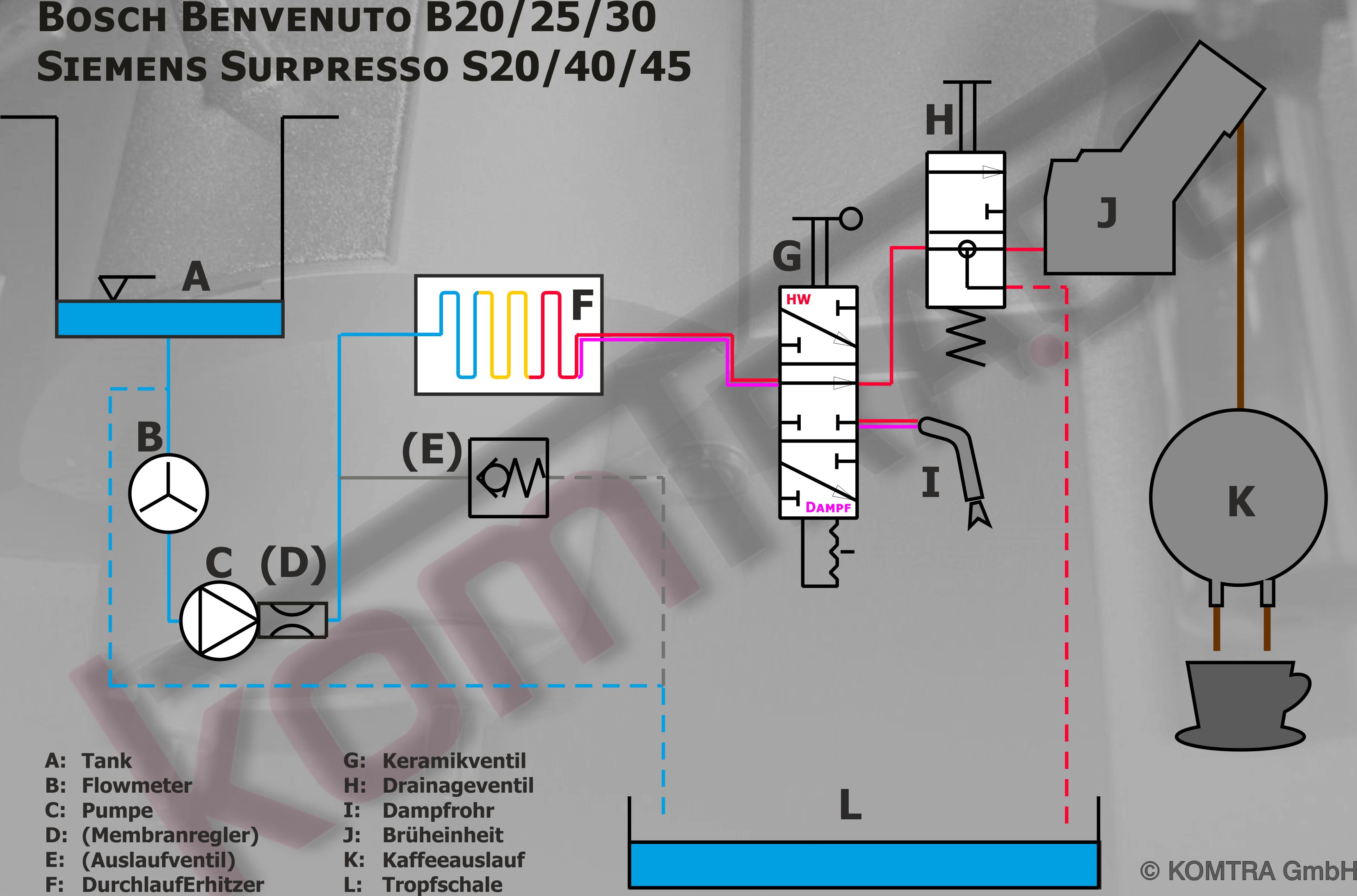

      I have identified the flowmeter/pump etc and there is no visible sign of leaks or damage. So, I need to check the water parts> remove the flowmeter first and clean ??? How??
    • You should check all water parts that there is no constipation.
      The flowmeter has bayonet lock at his cap. Turn the cap counterclockwise.
    • OK...removed and checked the heater and no blockages (easy to blow through; no restrictions).
      Replaced and tried the machine...pump is working (pulse s OK)
      To check the hose from the pump to the heater, I removed the spring clip to the elbow on the outlet side of the pump and there was a lot of back-pressure and water sprayed out. So I'm thinking that the problem is downstream of the pump and heater and not on the flowmeter (which I can not remove!).
      So it's the 3-way valve next??

      Tried to do another water-fill test and now have a 'close the door' error message. Refitting side panel failed to clear message, so microswitch (schalter turkontakt) removed and wires connected to short-circuit...no change. Now what? If I can't clear this fault I cannot see if all blockages are clear.
      Also I still may have to remove and clean the keramikventil but I can't get the front cover off...some stock photos on Komtra suggest that it is hinged...not on my TK64001/03. Any ideas ??
