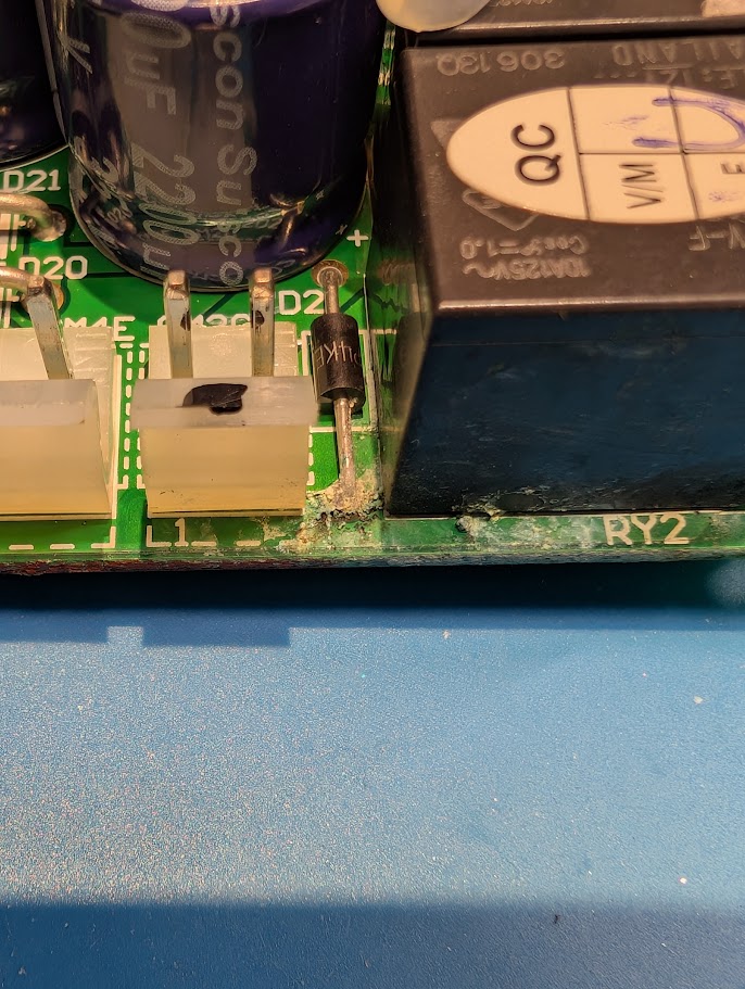

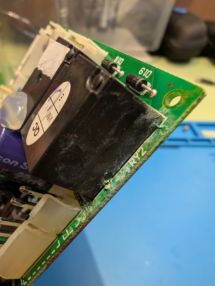

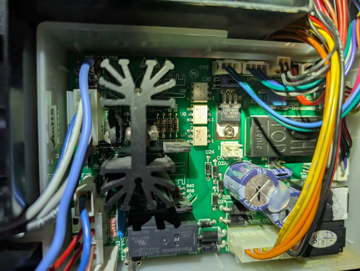

      I took the board out and there is some water damage on the bottom right corner by the relay and diode.

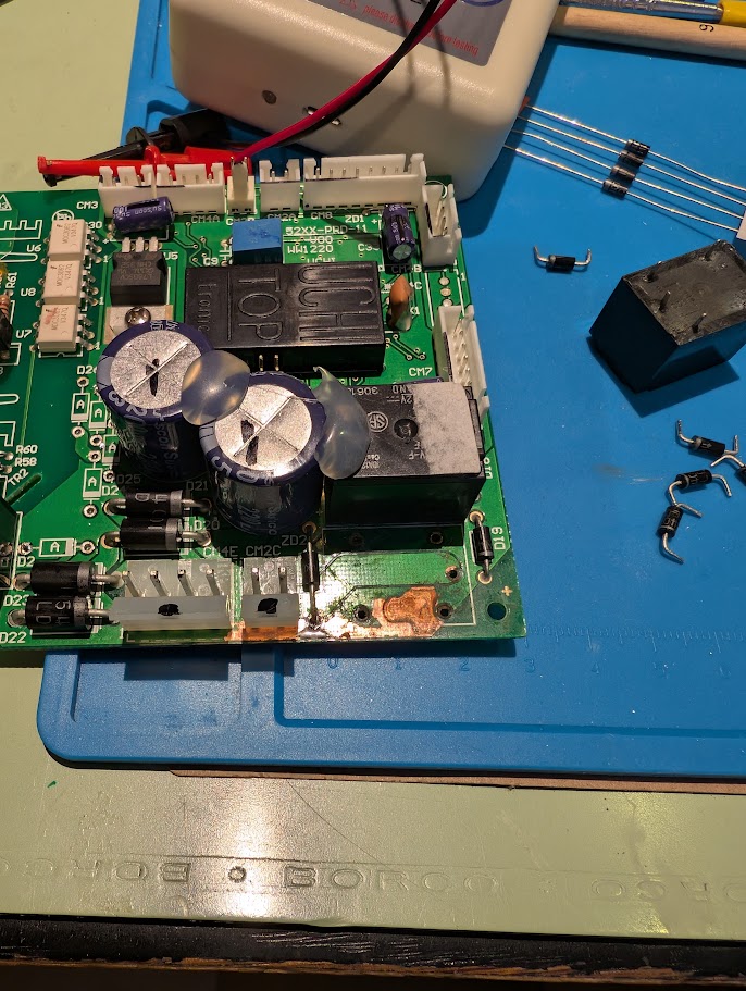

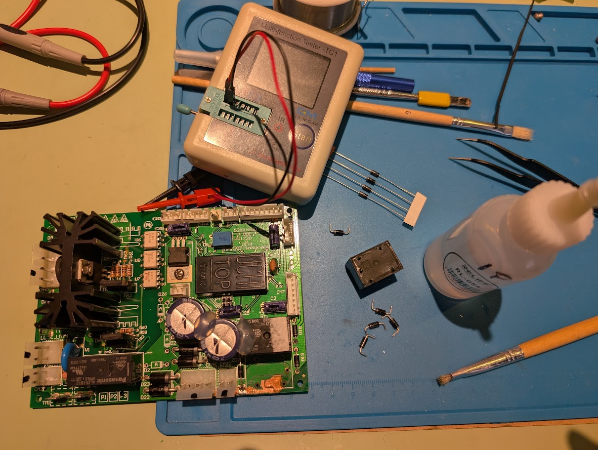

    • De-soldered everything suspect and to my surprise all components tested good and even diodes are within specs.
      The relay after cleaning all oxide on the outside looks sealed so I will reinstall it for now since I have no replacement cell phone.
      @Tobias.L
      EDIT:

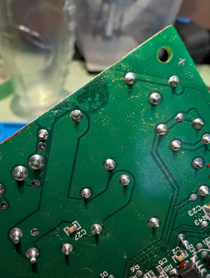

      Just to finish here, replaced those 4 Diodes as Tobi suggested and machine is now working great!
      I'm still puzzled why they all 4 test OK but, sometimes there has to be mystery :)
      Thank you for the help Tobi and BS!

    • The problem with the diodes is often not measurable and is/might also be temperature-related.
      It can also happen that the machine works for a while and then stops working again. I have a friend with a Jura A5 who wanted to come over several times because the machine kept turning off, but "just in time" before an appointment, it always worked again – and then for months.
      Since she doesn't want to go without coffee, she just keeps leaving it as it is...
      Just for the fun of it I will test them on professional machine that is designed to pick the best parts for critical reliability manufacturing.
      It will take some time when I have the opportunity to do that but I'll report back.
