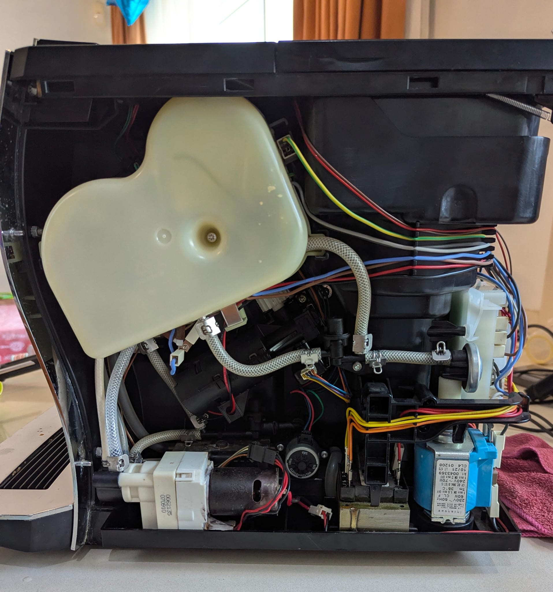

      Hi, I'm new to this forum but have been using the search function for the last couple of weeks . I've learnt a lot from you guys, but I'm still having some issues from my Z7.
      I have recently acquired a Jura Z7 for cheap that hadn't had much care and love. It has done around 8500 rounds in total but I think it is one of the early models.
      First time I switched it on it gave Error 8, but after a bit of searching I dismantled the brew group and cleaned it. Got it working somehow but the seals needed replacing and it needed a hose changed from the steam thermo block as it was leaking on top of the ceramic valve housing.
      Once the parts arrived, I overhauled the brew group and the drain valve and replaced the broken hose.
      I have run the descaling process twice and the machine clean successfully several times. Water now comes out super clear. I still have a noisy brew group motor but before I tackle that I wish to solve the issue below.
      I have an issue with the rinsing cycle. If I am not mistaken, when I first got it, while performing the machine rinse, it used to output water from the coffee spouts and when I ran the cappuccino rinse, it used to first output water from the cappuccino spout and then from the the milk frother. Is this how it is supposed to work? Because now when I am running the cappuccino rinse, I see water falling directly into the tray and then from the milk frother..
      Sorry for the long post, but I wanted to explain what I have done so far.

    • Thanks for the quick reply .
      Ok , so let try to explain better. During normal startup rinse, I get water from the normal coffee spouts but nothing from the cappuccino spout on the side. Same thing happens when I do a machine rinse.
      When I do a cappuccino rinse, I only get water from the frother , but no water from the cappuccino spout.
      When I do a machine clean, I get water from all 3 coffee spouts. Also when I choose cappuccino or latte macchiato it works normally.
      I'll try to post some videos ...
    • Hello.
      This is Jura-Standard and completely normal.
      This is completely normal depending on the machine type and software version of the Jura-Machine. Apparently also with the Z7.
      This Jura-Standard and completely normal.
      Then everything seems to work exactly as it should.
    • Hello there,
      Yes, at the end its normal behavior from the ceramic valve.
      The ceramic valve is switching position to/over the heat exchanger to release/drain any steam/pressure during machine shutdown into the water tray.
      Should make a "hiss" sound over the heat exchanger. That is an indicator that the heat exchanger is not clogged. Well, at least not completely clogged.

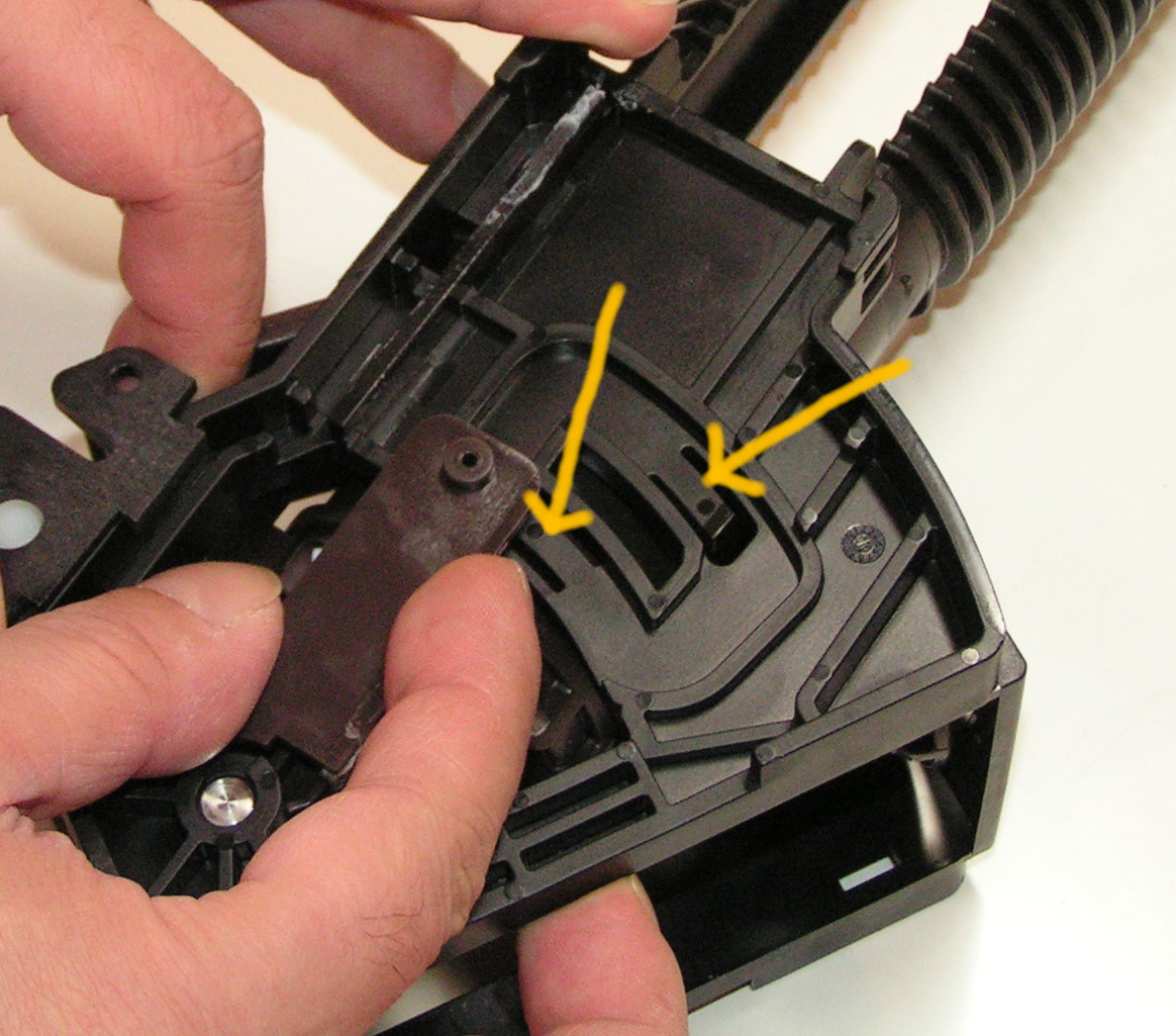

    • I'm on the highway right now without headphones.
      It is sounding normal to me.
      I'm just missing some "Click" sound produced from the brew group during movement.
      During the cleaning you have realised that if the lower piston is getting moved over the predetermined direction it has to pass a kind of a ratchet lock on both sides.
      komtra.de/forum/index.php/Attachment/2704-PICT0021-JPG/
      I will double check again later with headphones.
      But in general it sounds ok. Is the machine housing closed or open?
      During the cleaning you have realized that if the lower piston is getting moved over the predetermined direction it has to pass a kind of a ratchet lock on both sides.
      Housing is closed. When I moved the brew group manually I could hear those clicks, but they were pretty faint. Awaiting your response, thanks again.
    • If you have something to heat up carefully these latches to bend them up a little bit more so that the "click" is getting louder.
      It will secure the lower piston to not run "backwards".
      This can happen if these latches are not blocking a backward moving.
      A hot air iron with adjustable temperature would be the best.
      I use about 120-140°C.
      I also used a normal heat gun for that job. But you have to be very carefull. As soon the latches are getting "shiny" its time to stop the heating and bend them with a flat screw driver.

    • Thanks for the tip. I'll look into it when I get some time to dismantle the machine again.

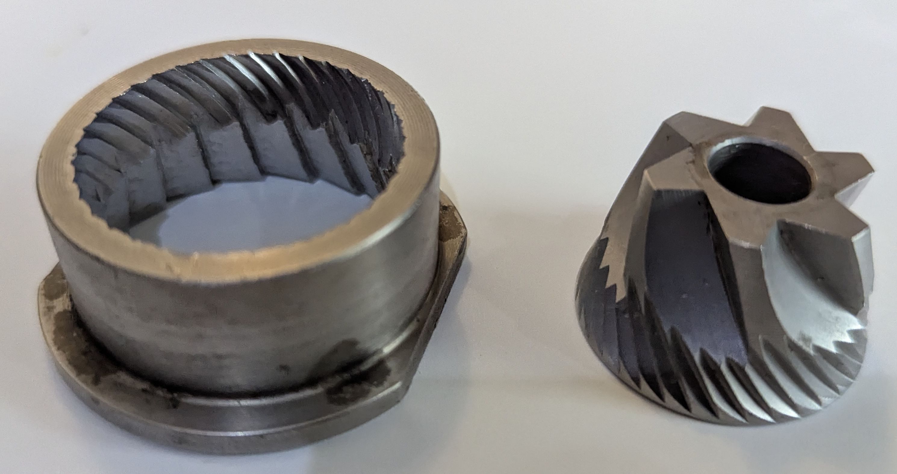

      I'll do some research on the grinder, to check consistency of the grind.
