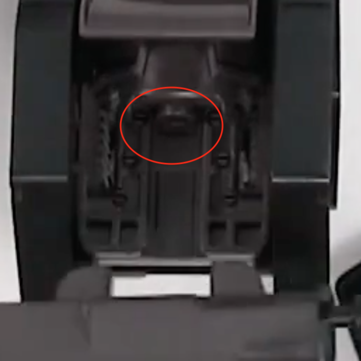

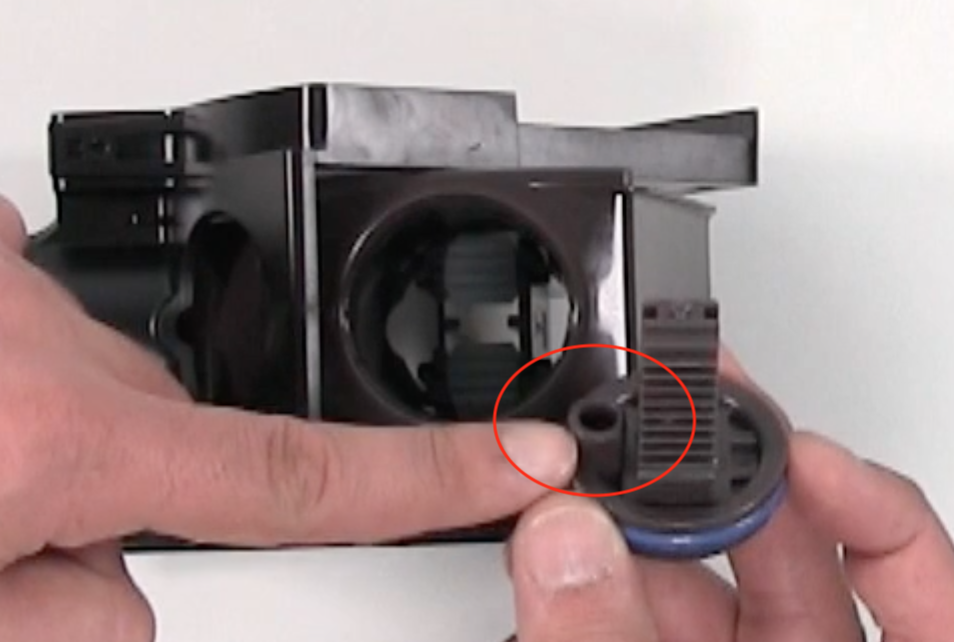

    • Hey guys. Sorry its on english my german is veeeeery bad ;)
      I figured this out. I had the same problem with the water running out in the bottom of the brewing unit.
      First i made service of the brew unit also rinse and greased up the o rings. After service the trouble was still there.
      But i noticed at the bottom of the brewing unit at the coffee press that it was not pushed to the very end, and the bottom draining valve was not fully in the bottom at the coffee press and the water was coming out in the rinse program.
      See the attached pictures, i have made a red circle around the tip on the coffee press were the draining unit should go in to.
      And as others in this thread was talking about that when it brews coffee the problem was not there.
      But that is because the coffee press is pressed all the way down due to the coffee in it and water is pressed in correct to the coffee press.
      So took it apart again and made sure that the press was going all the way down.
      After i put it all together again i made sure that the motor was able to push it all the way down and then the rinse was functioning correct.
      When it is happening it may be of the parts not greased up or the motor is the wrong position and not able to drive the coffee press all the way down.
      Hope this helps others with this a problem. :)

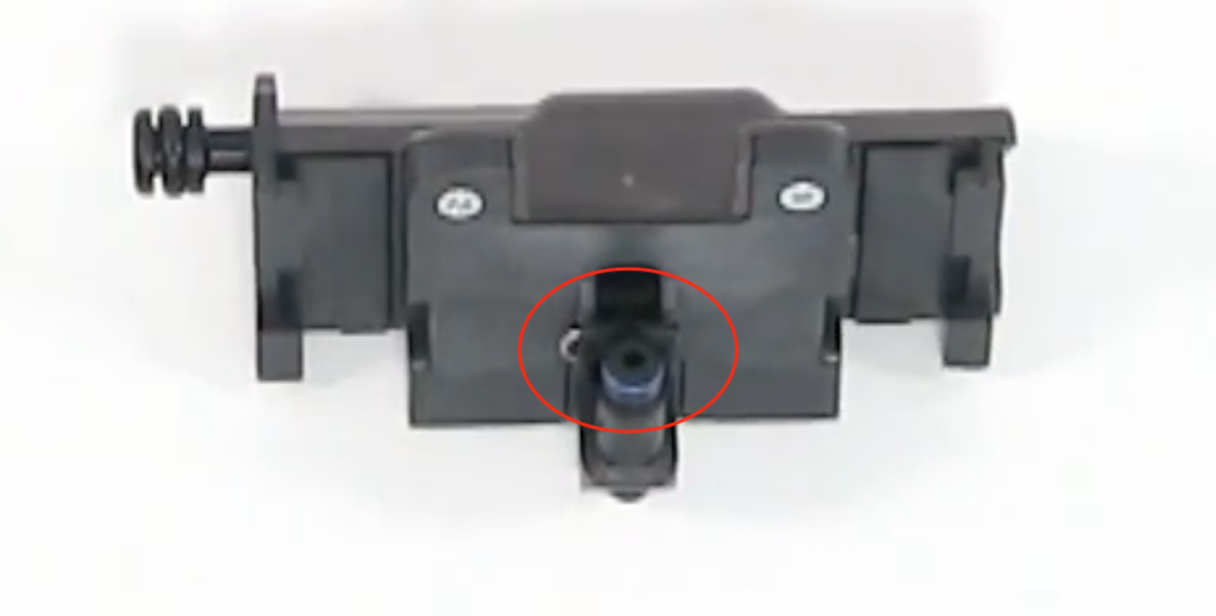

    • You also have to be attentive to take the right gasket for Picture 1.
      Its a little bit smaller than the normal "Druckschlauchdichtung" and
      there is only one piece of it in the "Wartungsset".
