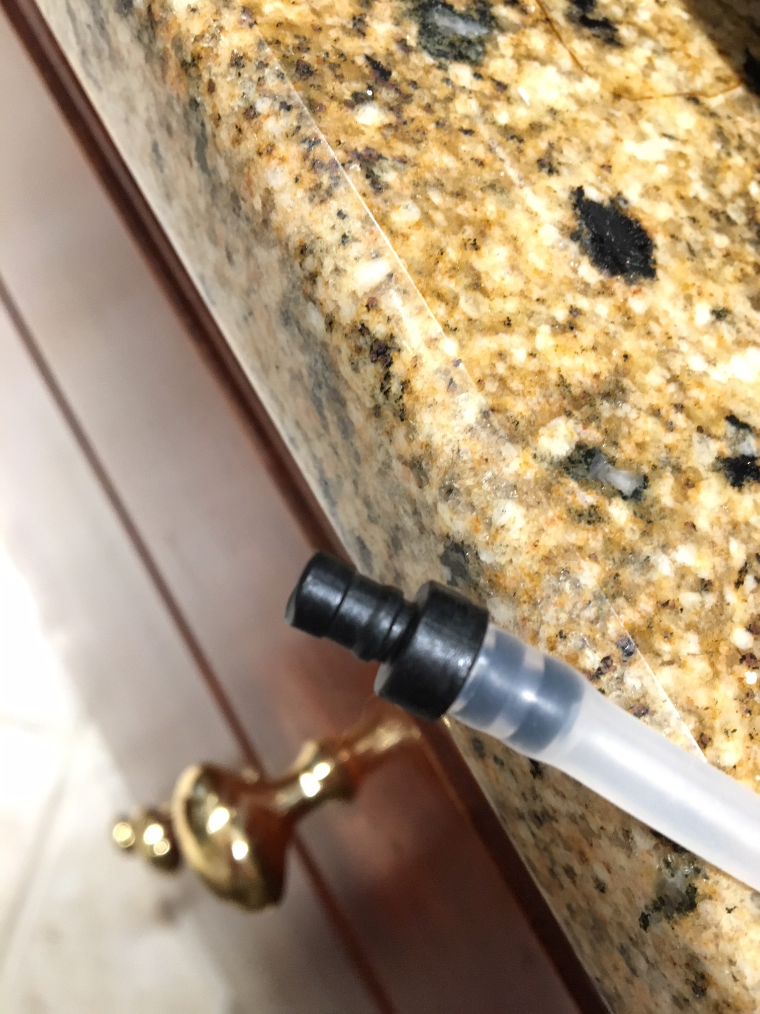

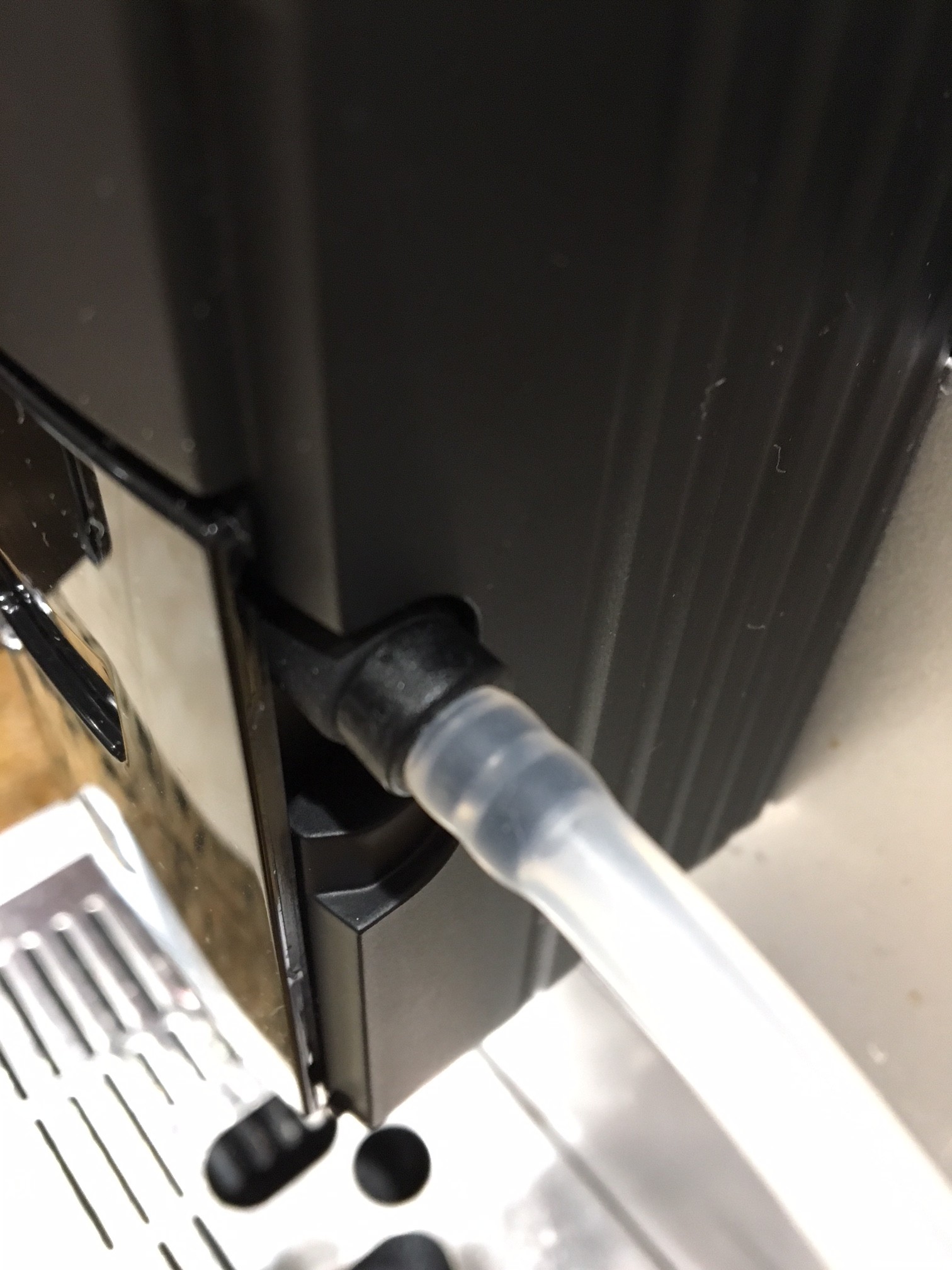

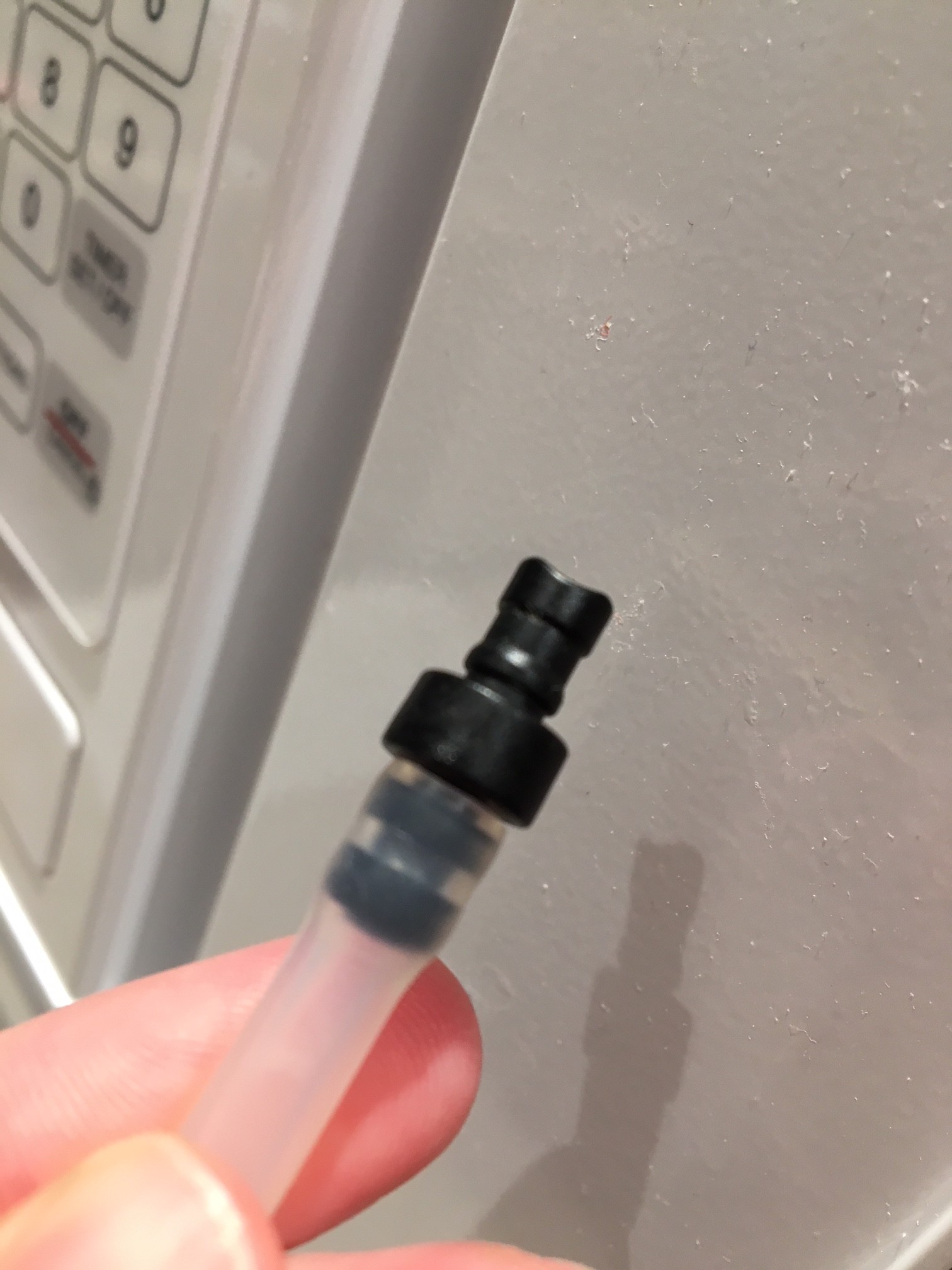

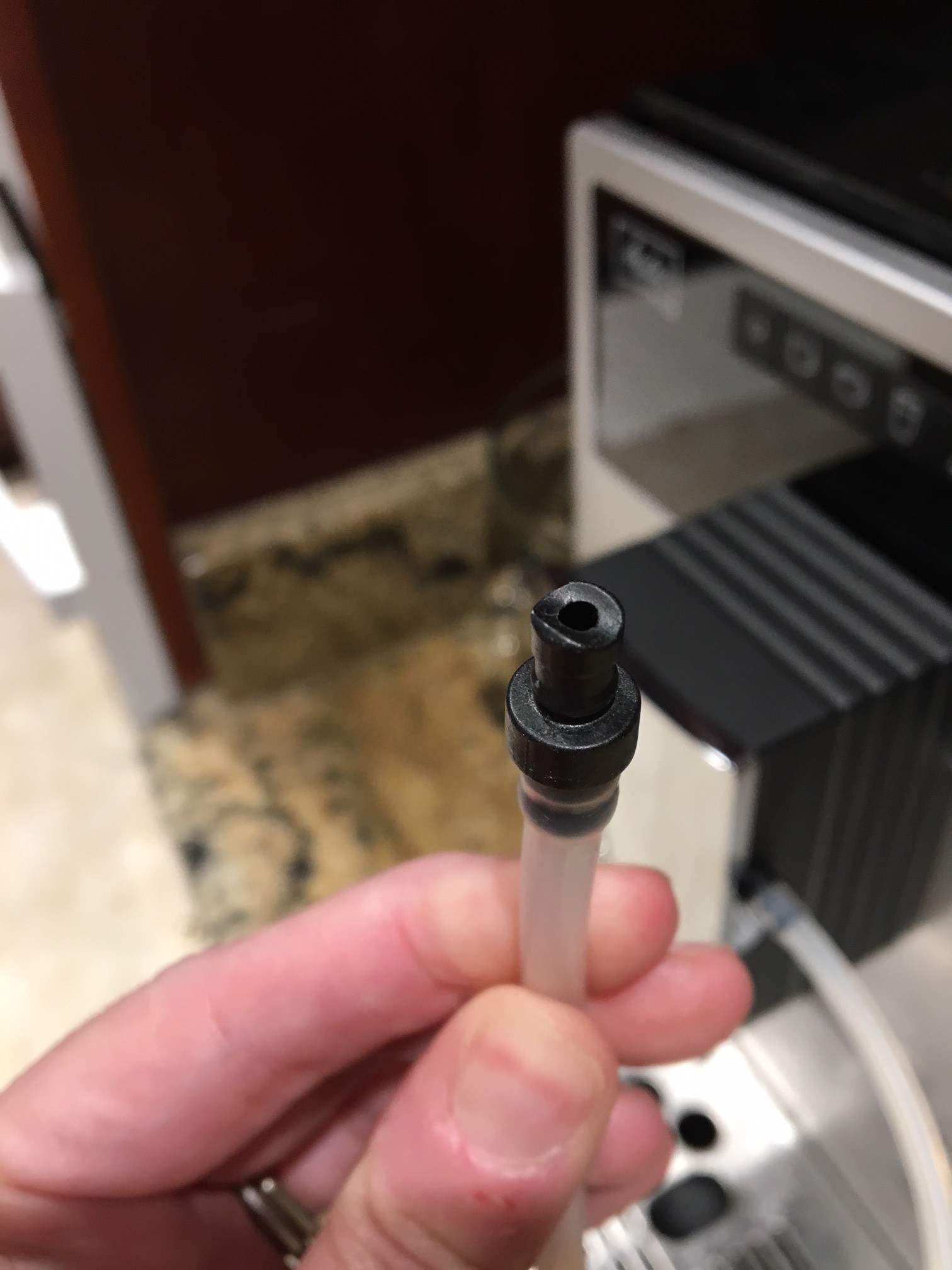

    • Here are some photos of the tube that connects the milk island to the machine. I do not see any defects in the tube or connectors, but it is the original tube that came with the machine. My husband asks what the red and white tubes attached to the Keramikventil do and if those could be causing the spitting of the milk. We did have to take them off and examine them. Is it possible that disturbing those connections is causing the milk to spit? Again, thank you for your thoughts and advice.

    • I also think the tube ist ok...
      But newer connectors at the tube have smaller holes.
      How much mm is the hole in the tube-connector. Melitta
      developed an new connector to avoid steam problems.
      Let see through the diameter of the hole whether you
      have the current or an "outdatet" version.
      The red tube brings the steam to the steam-spout.
      The white tube brings additional air to the Cappuccinatore
      to make milk-foam from hot-milk.
      Spiiting all the time can so not be caused from the white tube
      an spitting only by milk-foam an not by hot-milk can not be
      caused by the red tube.

    • I don´t know if it helps by your problem, but the hole in the new
      connectors from Eugster is just under 2mm (perhaps 1,75mm).
      A 2mm drill ist to thick and a 1,5mm drill wobbles in the hole.

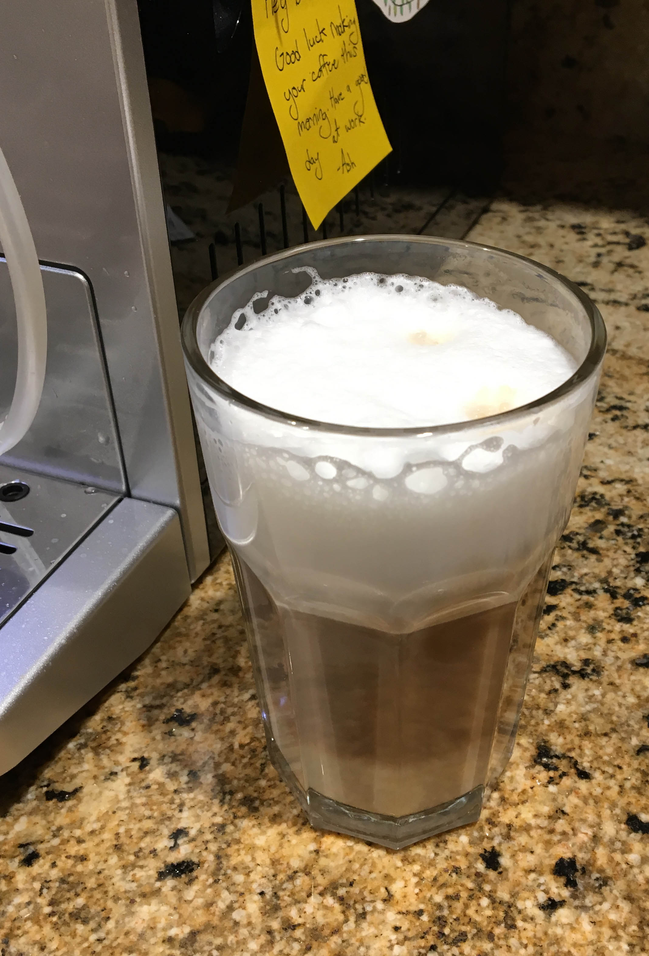

    • It has took 2 months to get my last order of parts, but I am happy to say that I now have a working machine!!! It is making beautiful milk foam and everything is very very hot. Replacing the Ventilauslauf made a HUGE difference. Milk stopped spitting and it was heating up the milk again. This part was newly redesigned so it looked a bit different than the part we took out. Once we figured out which way to install it the improvement was instant. I want to say thank you for all the advice and help in diagnosing the problem. Thanks so Very Very Much!
