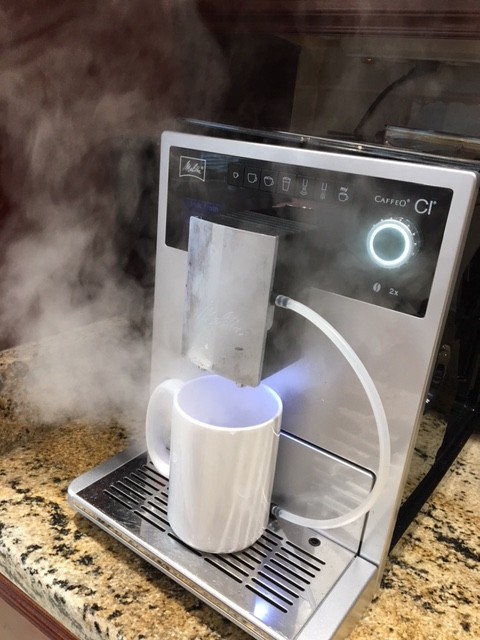

    • I just ran a test.... with the Milk Island NOT connected. When I push the button for Milk I get a lot of steam- A Whole Lot of Steam. I did then attach the milk island and with cold milk from the refrigerator I got milk that was only warmed to room temperature, not even really warm, just not ice cold anymore
      I just replaced the Auslaufverteiler Milchaufschäumer and the Ansaugdüse Milchsystem. Here is a picture of what the machine did without the milk tank attached. Also, I get very very hot espresso and water.

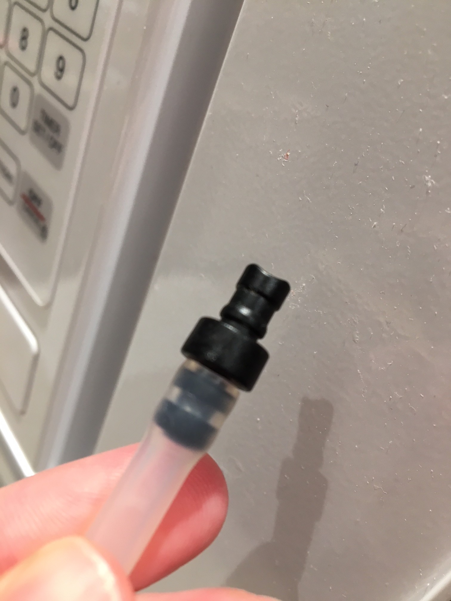

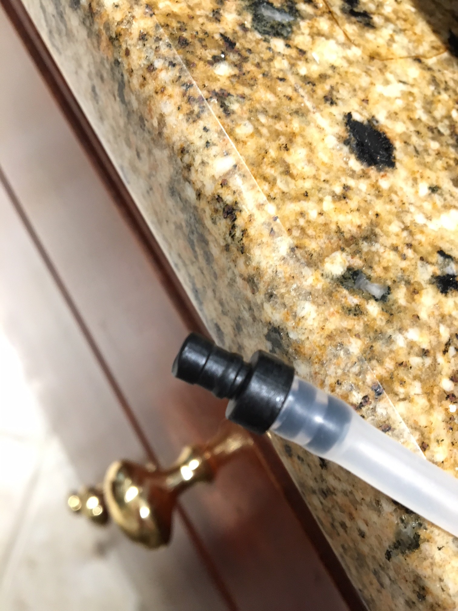

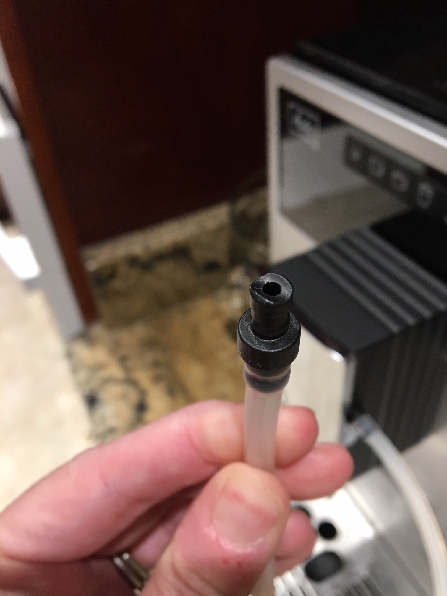

      Make a photo of the lower end of the cappu-milk-tube
      and post it here.
