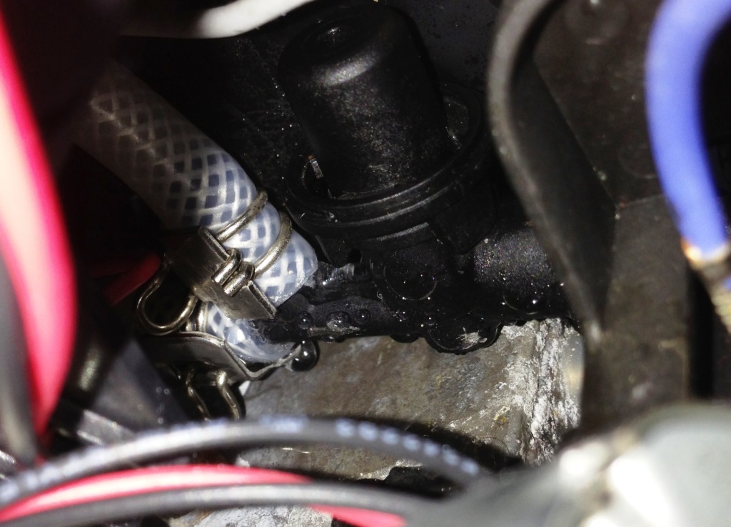

      I have a problem with a leak from the outlet valve/Auslaufventil - see the picture. The coffee maker still works, but there is always water under the machine after each coffee.
      I have already fitted a new silicon tubing and new hose clamps (new
      Silikon Gewebeschlauch and new Schlauchschelle, Sicherungsblech und Klemmfeder). This made a small improvement only. The problem happens under the high pressure only, when putting water into the espresso brewer.
      Any ideas on what other problems it could be? I checked to see if the outlet valve/Auslaufventil is cracked, but it looks OK, and I see the water coming from the connection. Maybe is the pressure too high? Or do I have another problem in the fluid system that is causing this leak. Any suggestions are helpful.
      Thanks, Andy

    • Hello,
      the main reason for leaks at the J5 are the very "damage-sensitive" tubes.
      If you make a little mistake during mounting the new tubes they will be
      damaged again.
      If the tubes are ok in your case, there could be a hairline-crack in your
      Auslaufventil (that may happen). Then you have to change this.
    • Thanks, BS. I did not see any problem with the tubes, and they seemed to slide onto the Auslaufventil quite easily.
      So is there some special tip for fitting the tubes? - I have a meter of silicon tube so can easily cut a new piece and try again.
      Or is it good to try some silicon grease or silicone sealant to make a good joint?
      Andy
