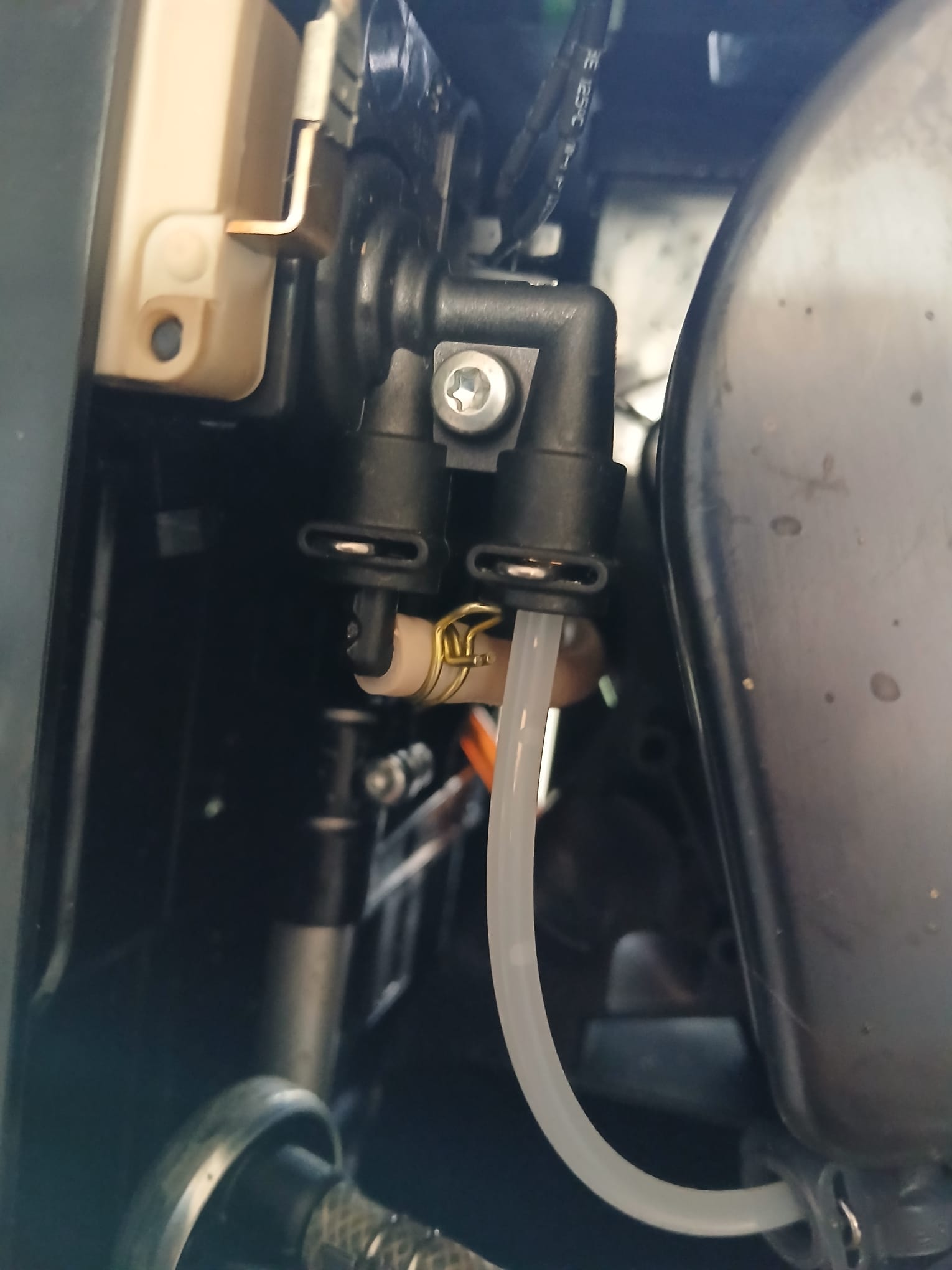

      Es handelt sich um einen E6 (EB).
      Die 90 Grad-Kupplung zwischen Ventil mit Drehknopf fuer heisses Wasser/Wasserdampf und dem Gewebeschlauch die nach die Dampfduese/Heisswasserdues geht ist ganz verstopft. Ich habe 2 Bilder angehaengt.
      Ich dachte: ich bestelle einfach einen Neuen.
      Aber ich kann dieser Artikel ganz nicht finden?!
      Weisst jemand die Bestellnummer dafuer?
      Danke!

    • RolandM schrieb:
      Manufacturer: Jura | Type/Model: E6 (G2) | Approx. Year of Manufacture: 2022
      Hello,
      It is an E6 (EB).
      The 90-degree coupling between the valve with the rotary knob for hot water/steam and the braided hose that leads to the steam/hot water nozzle is completely blocked. I have attached two pictures.
      I thought: I'll just order a new one.
      But I can't find this article at all?!
      Does anyone know the order number for that?
      Thanks!
      Mechanical knowledge: NO | Electrical knowledge: NO | Measuring device available: NO
      Look up part 62179, I believe that's the elbow only
      The compatibility they list for this part is strange, different site to site so it's not reliable.
      Some retailers specify compatibility based on actual usability, while others use Jura's spare parts references. Both approaches are valid...
      In this case, you'd have to check if it fits the E6 – but it usually doesn't appear because Jura specifies a different spare part for it and doesn't list a single angle for the E6.
    • BlackSheep schrieb:
      Interesting, would be nice to have actual crosschecking database.
      I think that elbow should work tho.
