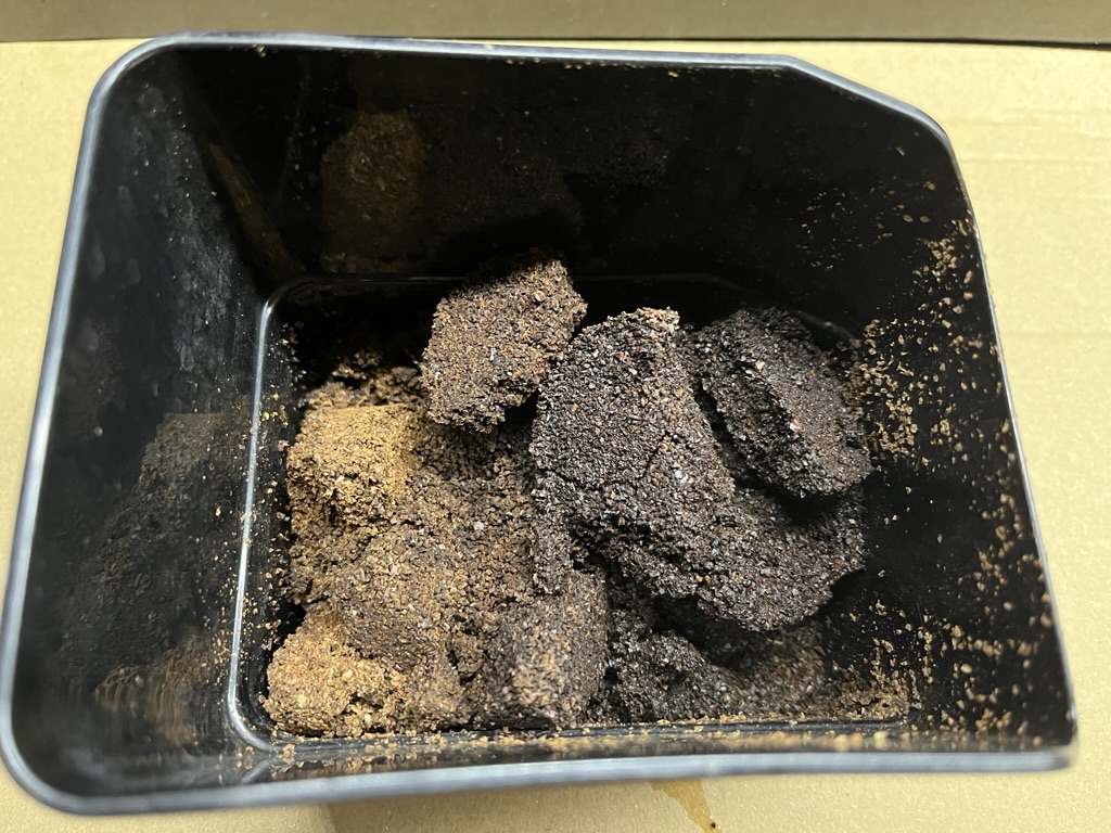

I can't get rid of the feeling that the grinder stones are worn out. There are really big pieces in the puck, see yourselves.

Doesn't look too coarse to me to be honest.
But you could disassemble the grinder and check if the stones have any obvious damage.
You can't replace the stones of this grinder as there are simply none available on the market.
Only option is buying a completely new grinder.Kontakt: sb_NUE ät stephanb.net -
Grinding stones normally lasts about 15.000 Cups.
Rest as sb_NUE says…Immer logisch und Schritt für Schritt vorgehen. Blinder Aktionismus kostet Zeit und Geld.
