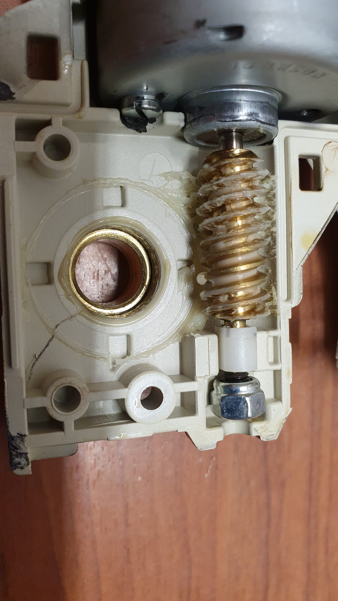

    • Here are some photos
        128,85 kB, 640×480, 160 mal angesehen
        79,81 kB, 640×330, 162 mal angesehen
        80,42 kB, 640×350, 157 mal angesehen
        68,09 kB, 640×330, 154 mal angesehen
        92,51 kB, 640×480, 165 mal angesehen
        124,26 kB, 640×480, 154 mal angesehen
        124,37 kB, 640×480, 142 mal angesehen

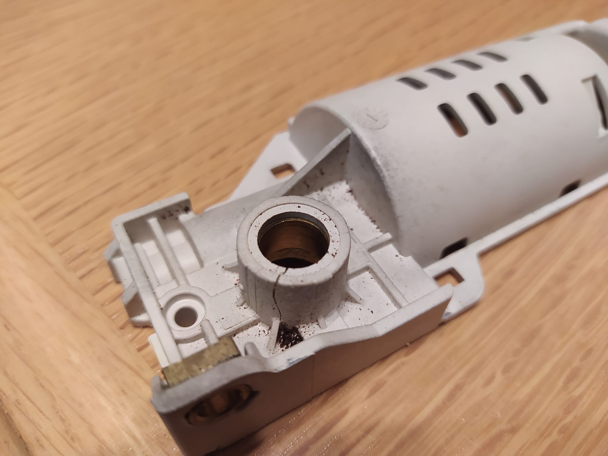

    • Hello.
      The problem is more that the shaft with the pinion has too much radial play. I can't imagine that the windy mount can solve the problem in the long term.
      Excessive radial play can come from worn bearing bushings or if the "tower" that holds the bearings has cracks on the "bottom" or in the shaft. I've had that before - but it's hard to see with the black plastic.
      Therefore, given the current state of knowledge (without using new parts), I see no other option than to reduce the radial play by bringing the pinion and the gear rod closer together so that excessive radial play cannot have a negative effect on the adhesion.
      Please also note that if the gear rod of the brewing unit is already broken in the lower area, the problem can recur very quickly. Then it may be better to rotate it so that the defective part is on top.

      Here is a photo of the only damage I could see
        94,91 kB, 480×640, 176 mal angesehen

      I do remember when I originally removed the motor from the Micro 9, there was some movement of the motor on the housing like the screws were not tightened properly and caused the motor not to be secured.
      I’m going to run coffee on both machines for a few days and give an update.
