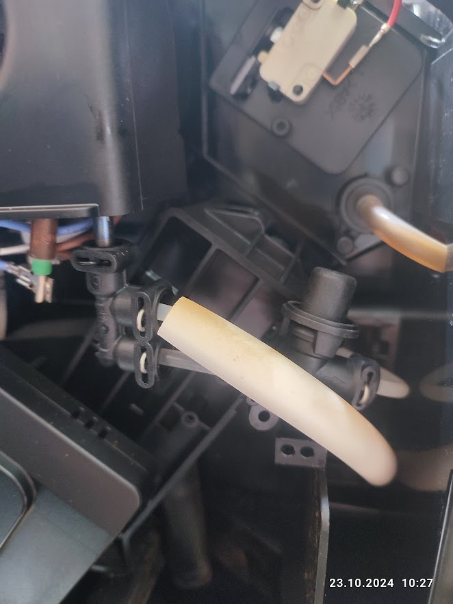

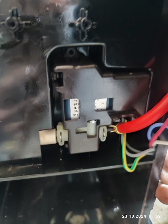

      Hello
      i did not find any data about Lat ticia f 30 ot 101 i have water coming from steam nozzle instead of coffee spout while purging and during shot also when turning off
      i disassembled the coffee spout but it happens before the coffee spout water are coming out from steam tube instead of coffee tube
      what part should i replace? any exploded view service manual or water diagram can help
      thank you
    • That machine is pretty new so there are no dedicated guides or water diagrams available yet. But it should internally likely be very similar to the Caffeo CI.

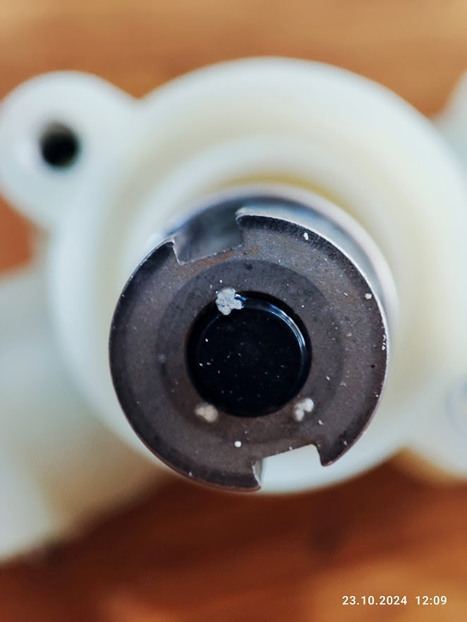

      Regarding your problem, disassemble the ceramic valve.
      Potentially a part of the internal drive is gone.

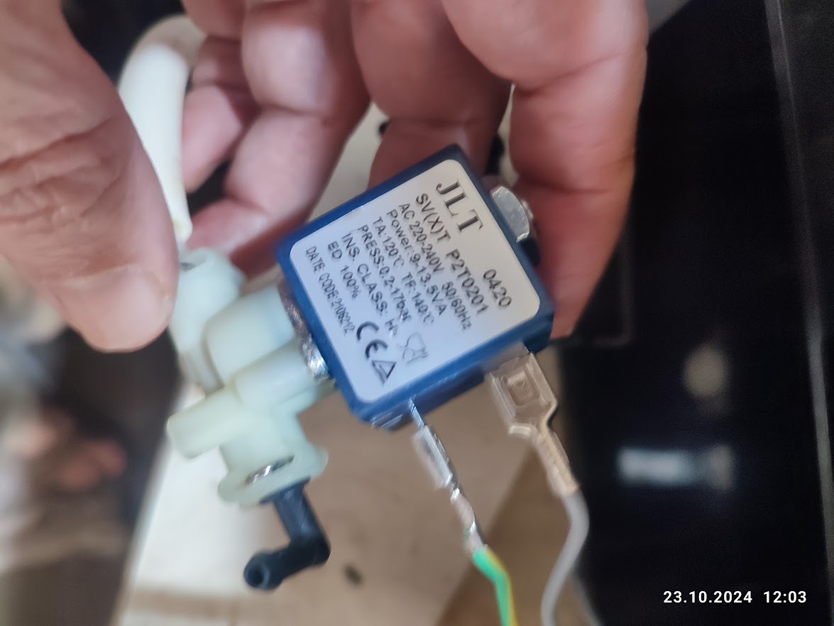

    • ok i solved it.
      it was dirt/limestone inside solenoid
      quite complicated to reach it but done
      thanks for the help
