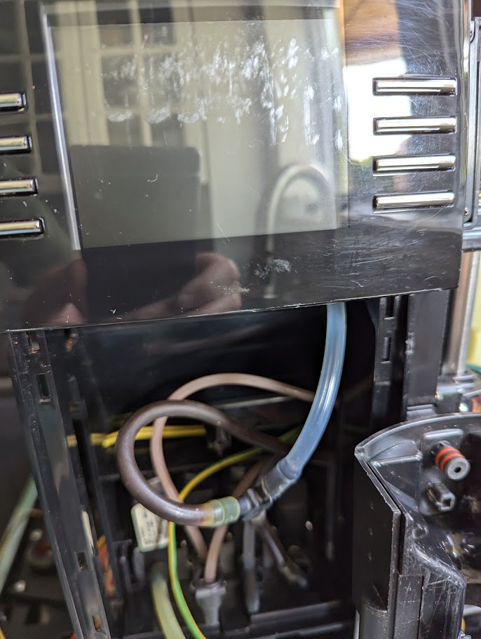

      The screen was rubbing on something in the package and now looks like this
      Anyone tried to polish this plastic with success? If yes, what did you use?

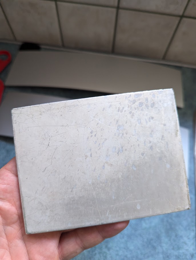

      Also like to know if it would be better to refinish the scratched aluminum by spraying
      or wrap it like a car with PPF film?

      I try to treat display damage like this with acrylic glass polish - it's a very time-consuming process - but it usually gets better. The problem with the rotary boxes is that they have a “protective layer” over the actual acrylic (or is it multi-layered?) How this will behave in the end is therefore even less predictable.
      If the anodized layer of the ALU has become so rotten in the dishwasher, you can no longer get rid of it "invisibly". I put a light film of silicone (or other food-safe grease) on top. This makes it a bit better - but here it is very unsightly - even with a light layer of fat you will quickly see that it looks different.

      I'm so tempted to remove the skin over the acrylic but not sure what would happen, don't have bad unit to test on.
      It would be very easy to reskin it in clear PPF like car headlights, except cutting the holes for buttons.

      Ordered brushed stainless steel looking PVC film (aliexpress.com/item/1005003943779592.html?)
      for the ALU parts and will try to skin those. Not sure about the material quality but it's cheap, so if it doesn't work out I'll try something else.

      I think there is one top layer shrinker over the actual plastic lense.
      I got one machine where it starts to delaminate in the corner and it looks like it got brittle due to UV damage.
      If I see something broken reasonably priced I'll buy it and experiment on that piece.
      Managed to buff out most of it, so for now it's OK.

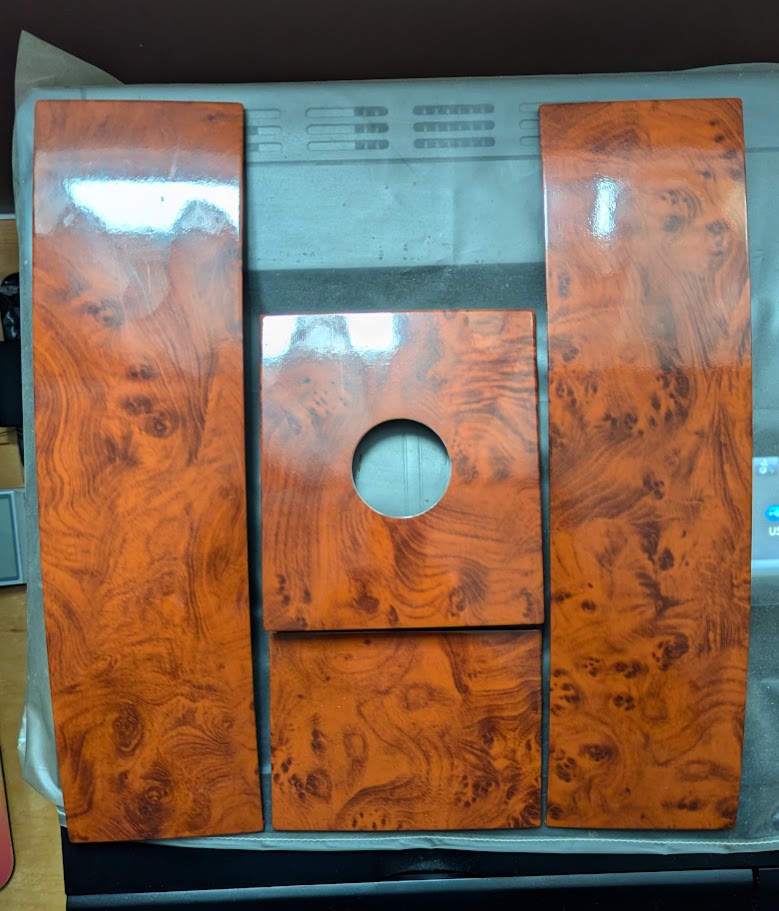

    • Just a little update on the alu refinishing, the wrap is easy to work with, biggest challenge is always the outside corner,
      but it's doable. I'm more and more tempted to do the lense on the display but still need to see what happens when you strip
      the original protection applied to it.

    • Looks cool.
      Make a picture of the whole machine when finished…
      What foil is it? Walnut? Which manufacturer?
      Here most people use „carbon“ design.

      Will do, it will take a while since I need to replace the spout LED on it so the spout is in pieces.
      Also managed to fix the hot water tensioner belt that was thankfully only ripped out of the plastic clip
      so epoxy took care of that.
      Walnut would be darker and more dark brownish color almost black.
      This is some kind of curly brazilian cherry.
      Got it from Ali and the quality and thickness is very good. Paid about 1/2 what is the price now. aliexpress.com/item/1005006270931594.html?
      Also got clear and stainless steel foil but this stole the show when I got it :)

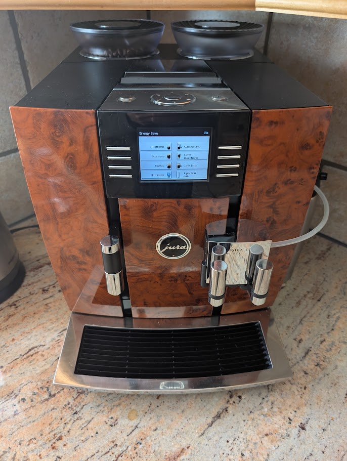

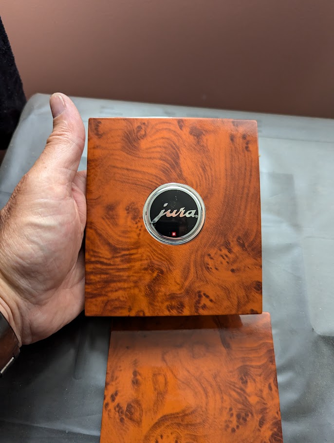

      Well, done, except the coffee spout is fixed since the gears inside were used for X8 pro machine I needed to complete :)
      Managed to refinish the clear plastic part of the display (very labor intensive) stripped the top foil and polished the plastic like car headlights, masked the display area, sprayed with mat black and topped the whole piece with clear coat used on car headlight lens.
      Fixed the bad amber/white LED by ordering custom LEDs from Asia. Perfect match and slightly brighter than original so swapped both of them.
      Also installed automatic water filler so it is connected to the water supply - best feature ever
      Only thing now I do NOT like about the Giga 5 compared to the X8c is that you can't rename drinks and replace what drinks appear on the front screen.
