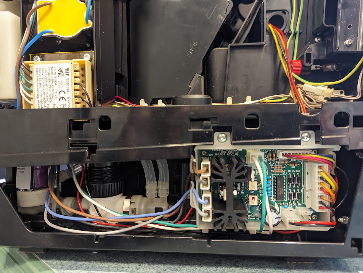

      I'm surprised that it didn't leak before the Sysko pump let the water to go in.
      From the Jura install manual the say that incoming water pressure can't exceed 4 Bar (about 70 psi).
      I'm confident I got that correct so must be the internal pressure regulator.
      It looks very similar to the one you find on any air compressor but in this case it is all plastic. To take it out would be major pain so I added one from reverse osmosis water purifier before the inline filter feeding the machine, and that solved the problem for now.
