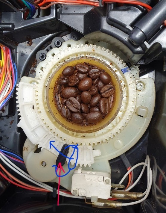

      This concerns the GIGA ceramic grinder I need to do a manual adjustment of the actual grinder to make it grind FINER than it does currently. On the grinder, there is a calibration flag or clip that CAN BE MOVED to make it grind finer or coarser. Ok, I moved this flag so it can grind finer but the JURA machine somehow has to relearn this setting like it relearns brewer position, HOW DOES IT DO THIS AND WHEN? I need it to relearn the physical grinder settings!
    • The basic setting of the mill on the GIGA can only be carried out using Jura's
      Animation-Software. There is no regular way to do this any other way.
      The only “other” way is to outsmart the machine. To do this, you have to remove
      the clip manually and reinsert it further away (from the recess in the light plastic
      frame). Then continue to close the grinder "forcibly" by hand (this can be VERY
      HARD) until the black clip fits exactly into the recess again. It may also be possible
      that the adjustment motor has to be unscrewed at the bottom in order to be able
      to turn it.
      Before this activities, the grinder must be set to medium grinding level in the
      programming settings.
    • Ok! We got the exact answer here, so good of you, now I know!. Since I repair Juras at our shop in California for a fee, I am reluctant to force ANYTHING because if I break something I will be the one to ship it to Jura for 500€ or more which I will need to pay for. What does Jura's animation software permit you to do besides this? Are only authorized sellers of JURA allowed to have it?

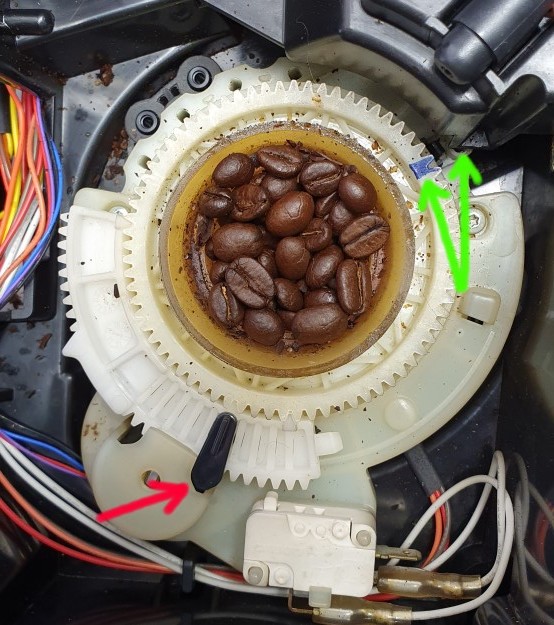

      A few additional information about the basic grinder settings.
      The blue adjustment mark in the picture must point exactly to the screw hole (green arrows). In this position, the two ceramic discs are at the correct distance from each other in the basic position. The black clip is inserted exactly like this (red arrow) so that when the grinder is moved with the animation software, the device recognizes where the basic position must be:
      (The black clip is irrelevant for normal machine operation - it is only needed for the animation software to move to the positions; you can only easier see visually whether the mill is in the basic position)
