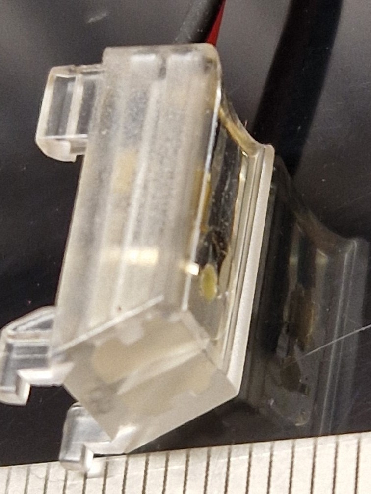

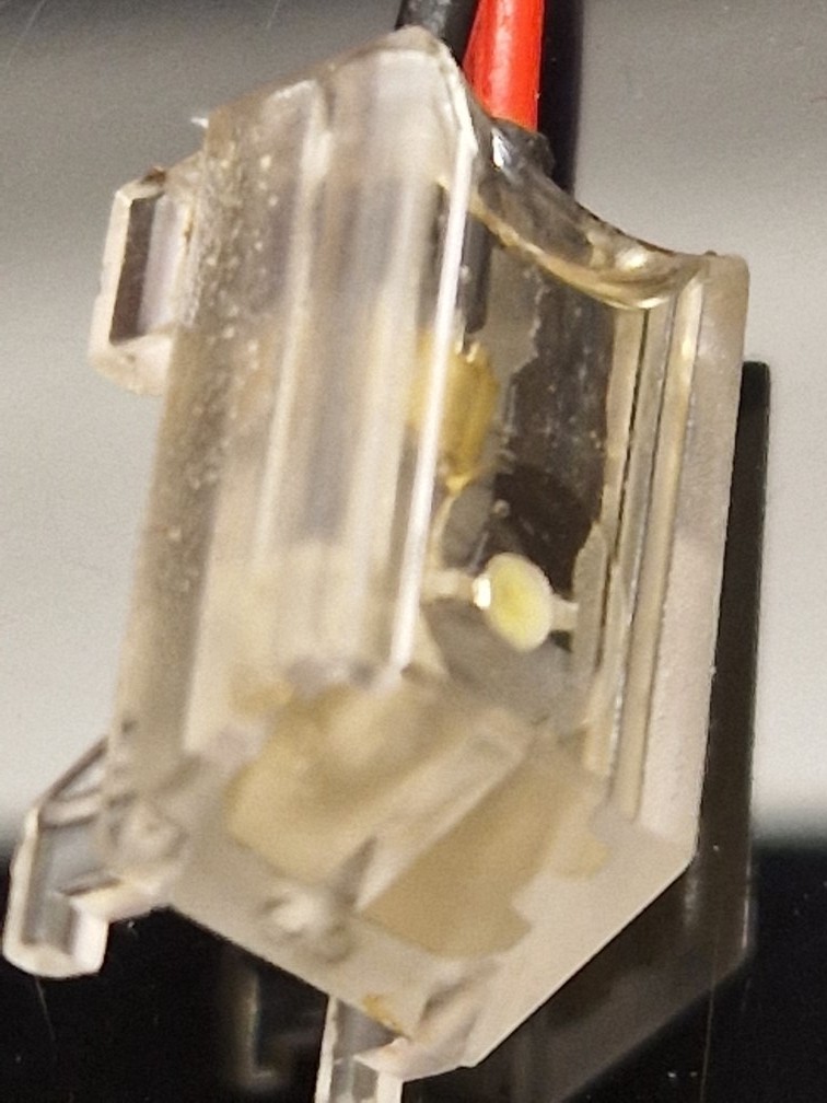

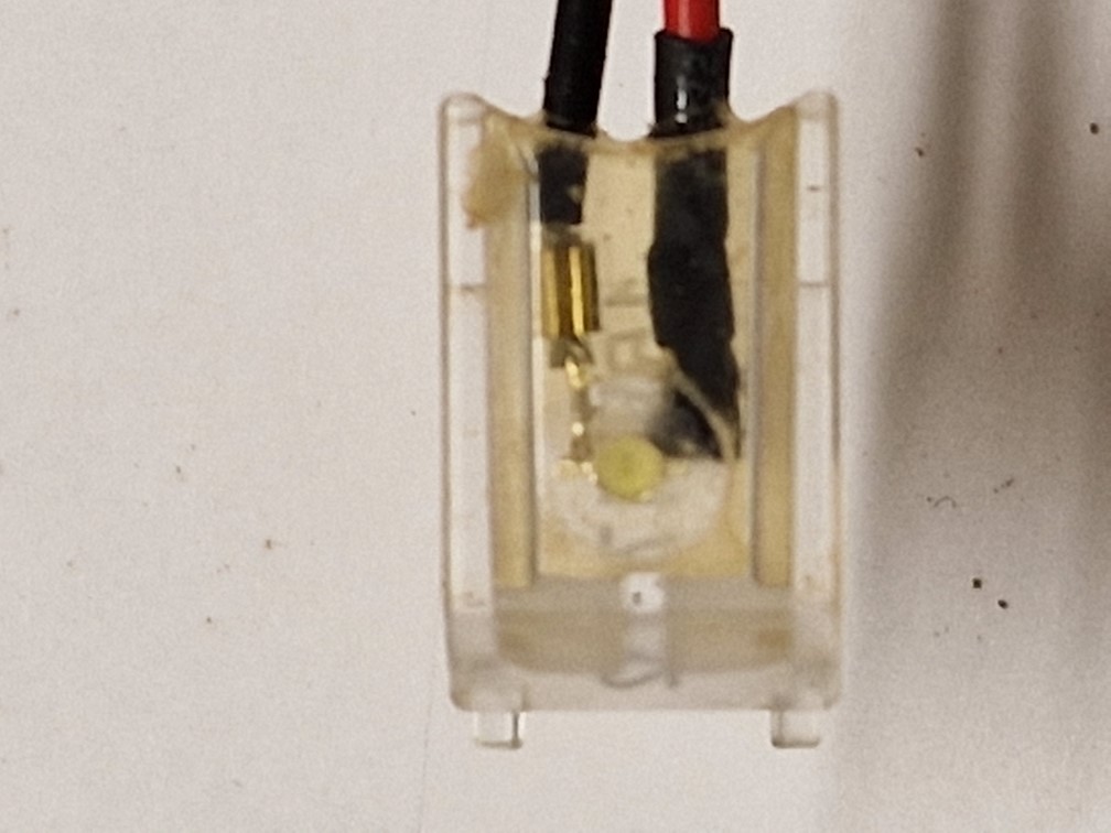

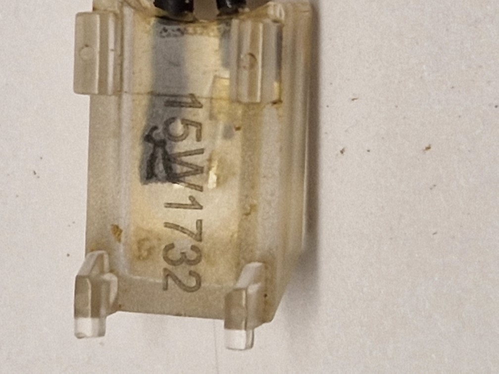

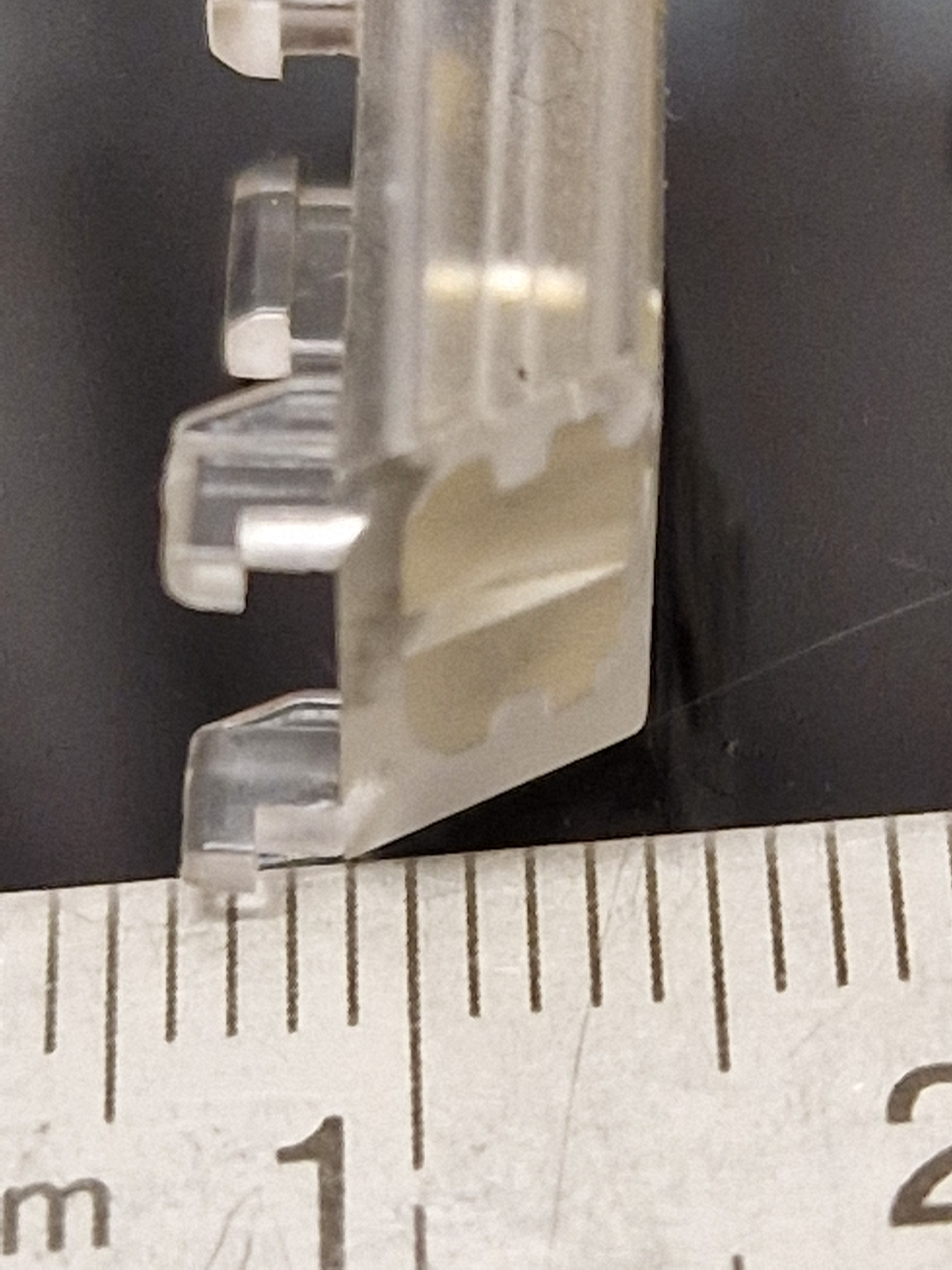

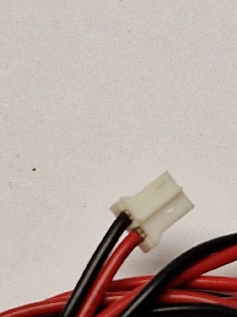

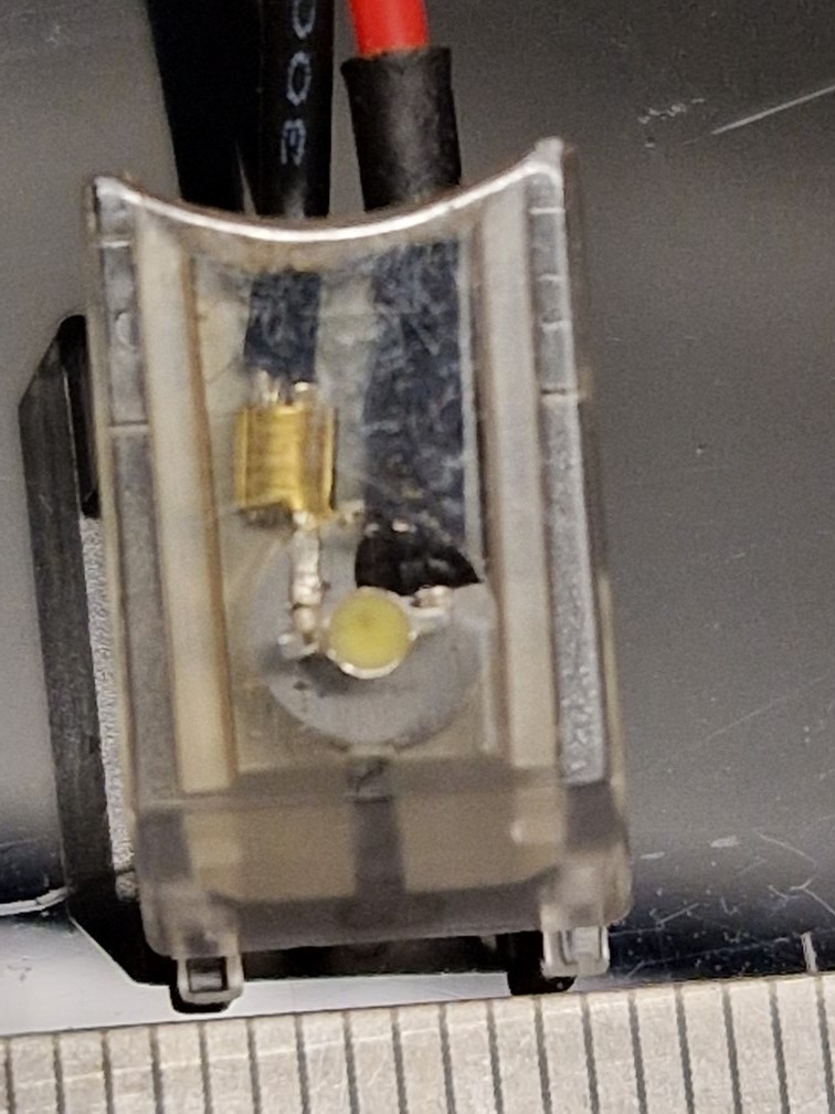

      BS, would you have any pics of the LEDs and voltages you measured?
      Thanks
    • Hello,
      I have a few pictures, but they are a bit blurry - if that's not enough, I'll have to try to get them better:
      The LEDs are cast into the plexiglass holder. The voltages (I don't know where "+" was applied) are about 2V in one direction for "Amber" and about 3.2V in the other direction for "White". Maybe 1732 means 1.7V Amber and 3.2V White
      I fear that the LEDs will simply overheat and not be cooled enough because, in addition to not dissipating heat, they are also in the area of hot water vapor. In other Jura-devices, cup lighting failures are not so common, they last “forever”.

    • Du siehst auf dem Bild die Leuchtfläche.
      ist also eher eine flache Scheibe, bei der
      seitlich die Kabel rausgehen - zumindest
      erscheint es so…

    • No, I think it's something completely different. The 2mm LED seems to be
      rather flat and like a yellow disk and does not have a classic LED housing.
      Here are a few better pictures:
      Rather flat and like a yellow disk and does not have a classic LED housing.
      Great pics! Thanks!
      Yes, that is pretty much the same thing in different packages, those are available as well and generally produce more light,
      and applied over aluminum cooling plate.
      This type is used in light bulb assembly.
