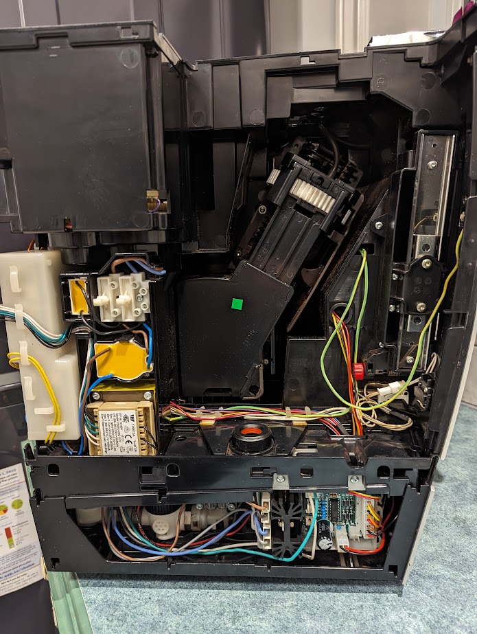

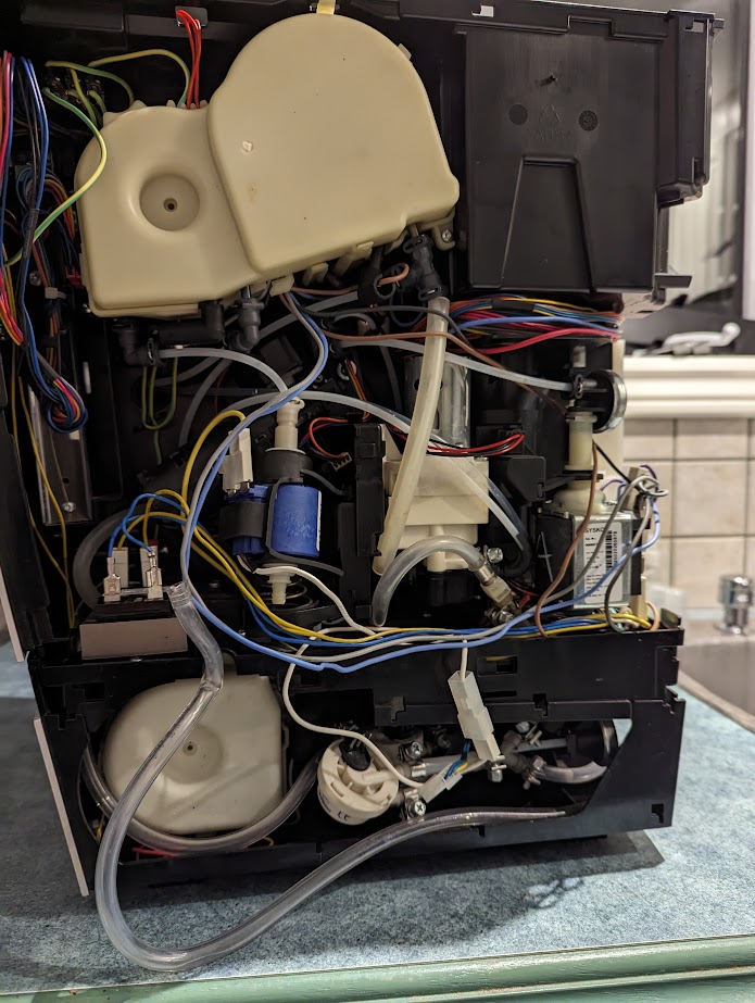

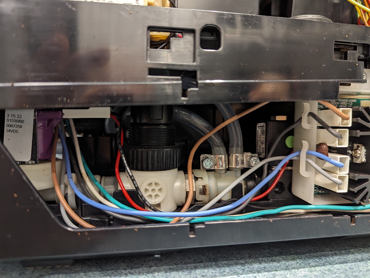

      I just acquired this machine and looks like someone did hose replacement on it... no idea why ?(
      Needless to say the job they did is terrible, using cheap plastic hose that is stiff, kinking, and every connection has clamp on it.
      Can someone please tell me the correct pant size for the job?
      Are they all the same from what you can see?
      I assume these are all low pressure connections so silicone hoses, and no clamps needed right?

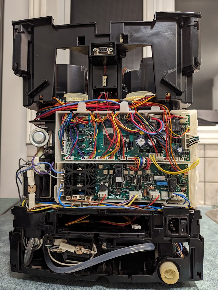

      Another of topic question,
      what is the connector in the compartment on the back side of the machine for? (beside the power connector and main switch)
      Thank you!

    • This ist the right hose:
      komtra.de/jura-ersatzteile/jur….0xwd2.0mm-meterware.html
      No clamps are needed for this hoses.
      Look where the cable is connected to the board and
      write here whats the connector designation at the board
      like „CM4E“.
    • BlackSheep schrieb:
      This is the right hose:
      komtra.de/jura-satzteile/jura-….0xwd2.0mm-meterware.html
      No clamps are needed for these hoses.
      write here what's the connector designation on the board
      like “CM4E”.
      Thank you!
      The connector is marked CM4F

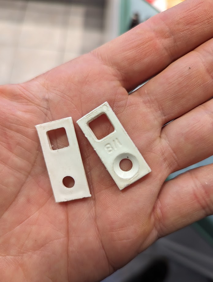

      Also found these two loose in different spots inside, any idea what is it for?

    • Never seen this.
      The cable ist for „CCU PCB“ - no idea what is it for:
      Seems you can connect some of the following:
      - MCU
      - VDD,GND, RX/TX (3.3V) from MAIN !
      - 5V linear regulator
      - MDB interface
      - Milksensor jack
      - LAN
      - No NRI !!!
      - D-Sub connector

      Perhaps someone was working on several things at the same time and I got extras :D
      Interesting, thank you!
      must be for some kind of module since the compartment is shaped like a drawer and there is locking clip at the very back of it.
