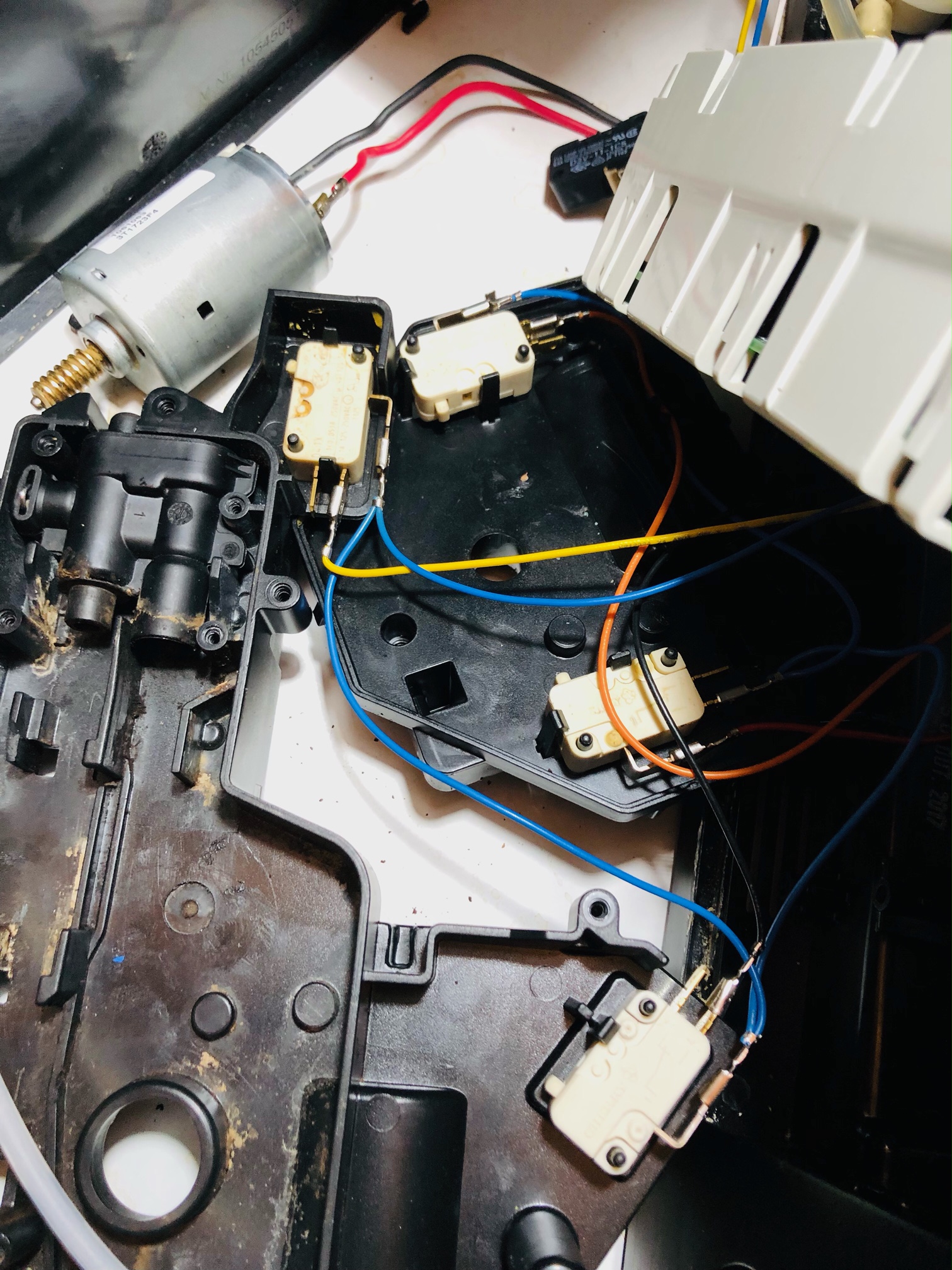

      CM5300 stucked in degrease brew unit program with "empty drip tray" error.
      I entered the service menu, no error is shown. Unfortunately I can't find either service manual or drawings for this machine.
      I took it apart, all 5 microswitches I found were tested and worked fine.
      Can anyone guide me where can I find the drip tray sensor / microswitch?
      According to other tabletop machines, the drive motor should start before the heating, but nothing happens. I tried to remove the drip tray for half minutes and put it back, but it didn't help.

      If the machine recognizes putting out and in of the tray,
      And still shows incorrect behavior, it might be a control
      board defect. In this case it shurely wouldn´t help to change
      a switch or a motor.
      But I don't know anything more than just pictures from the
      CM5300, so there could also be hidden causes that I don't
      suspect - even the switch or motor.
