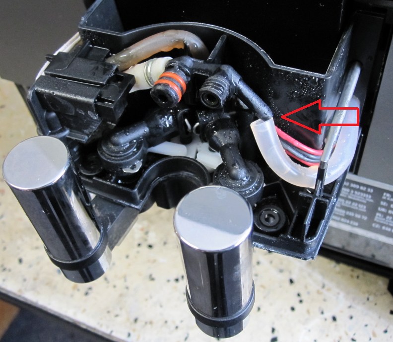

    • The panels in silver has three. look at the photos:
      All my three Z6 had plastic panels, so I can‘t
      say anything to metal panels. I only knew that
      behind the plastic panels screws are hidden.
      Perhaps its enough to loose the screws at the
      bottom of the front and you are already able to
      clip ist out at the top complete…
