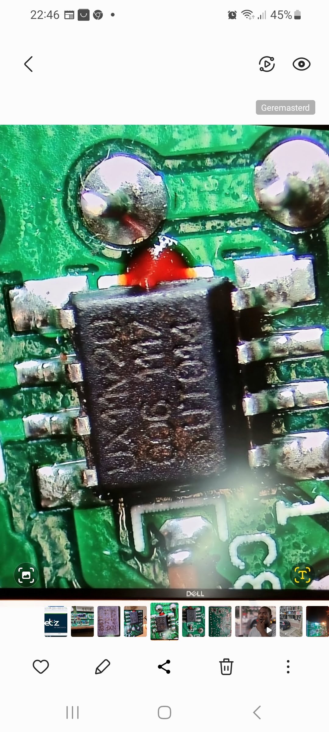

    • @RolandM you wrote you repaired a few giga powerboards. can you tell me more about the UX11v20 8pin chips which are obsolete, do they die easily or did you never have a dead chip ? from what i found on the web it is a dc/dc convertor and comparator chip and i was curious if there is an easy check to detect it is ok or not ok. it activates one or more relays on the powerboard.
      It sometimes goes bad indeed, I had it once or twice with another Jura pcb. It seems to be an IC that was especially was manufactured for Jura, as no datasheet or further info is available: easyeda.com/component/b236039157f04fb880a815e37583c8c0 says "Specialized chip found in Jura coffee machine AC/DC PSU. No equivalent exists. These chips blow then a replacement design is necessary. See my replacement design for this chip." But I never really looked into that.
      • thanks for the info i found the schematic earlier tonight. after i discover the relay pin (same pin connected to the ic) is bridge on the other end of the powerboard by the previous owner. i suspect the chip. do you know how a working board should act.

    • Hi i read on many places it is difficult to move this chips from one board to an other board because the chips die easy? but i guess they are heated to much and fried but with low melt solder no problem from my perspection.
      i am curious about response from people who killed these chips while soldering. Can somebody respond please... !!
      or people how have a board with this chip laying arround i am willing to buy a good chip.

    • i am looking for a board with an UX11v20 (8 pin) chip. to transfer for my blown chip.
      if they bridged the relay pin to bypass the chip, i know enough.
      so i am curious if this forum brings me in contact with a board owner from for example a XS90 ( older jura machine), so i can start to make the powerboard back to original.
