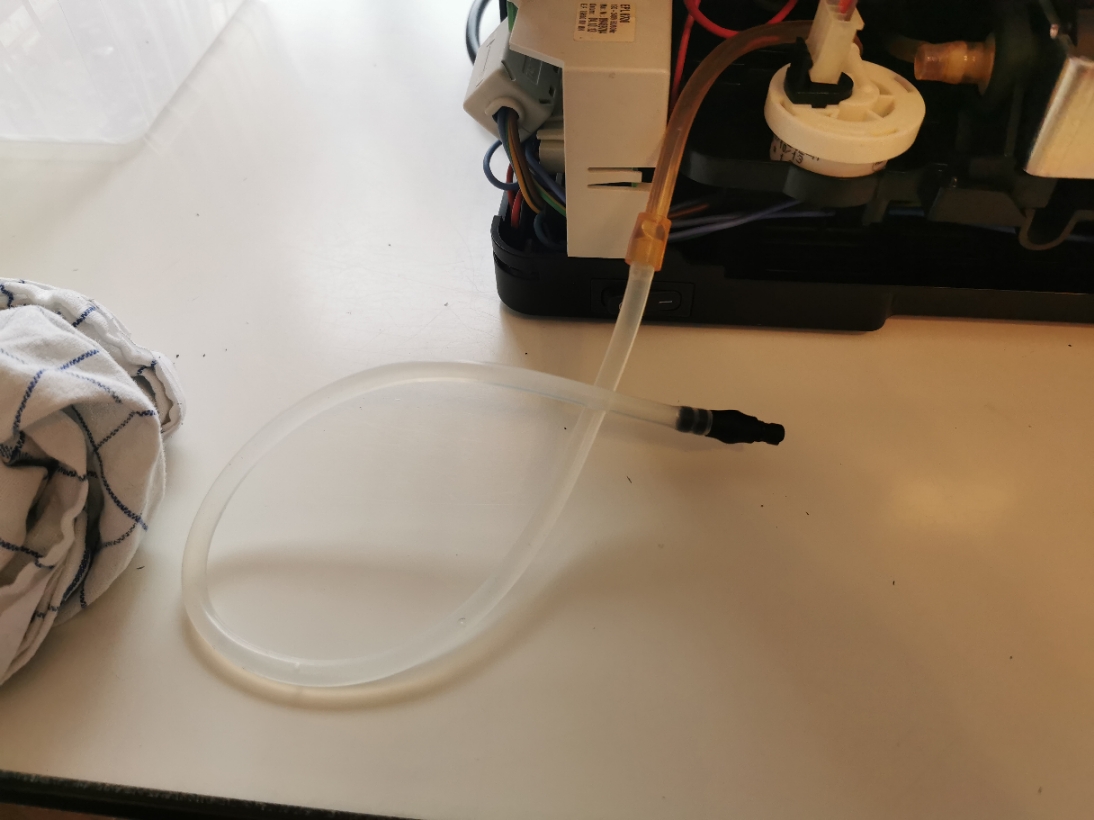

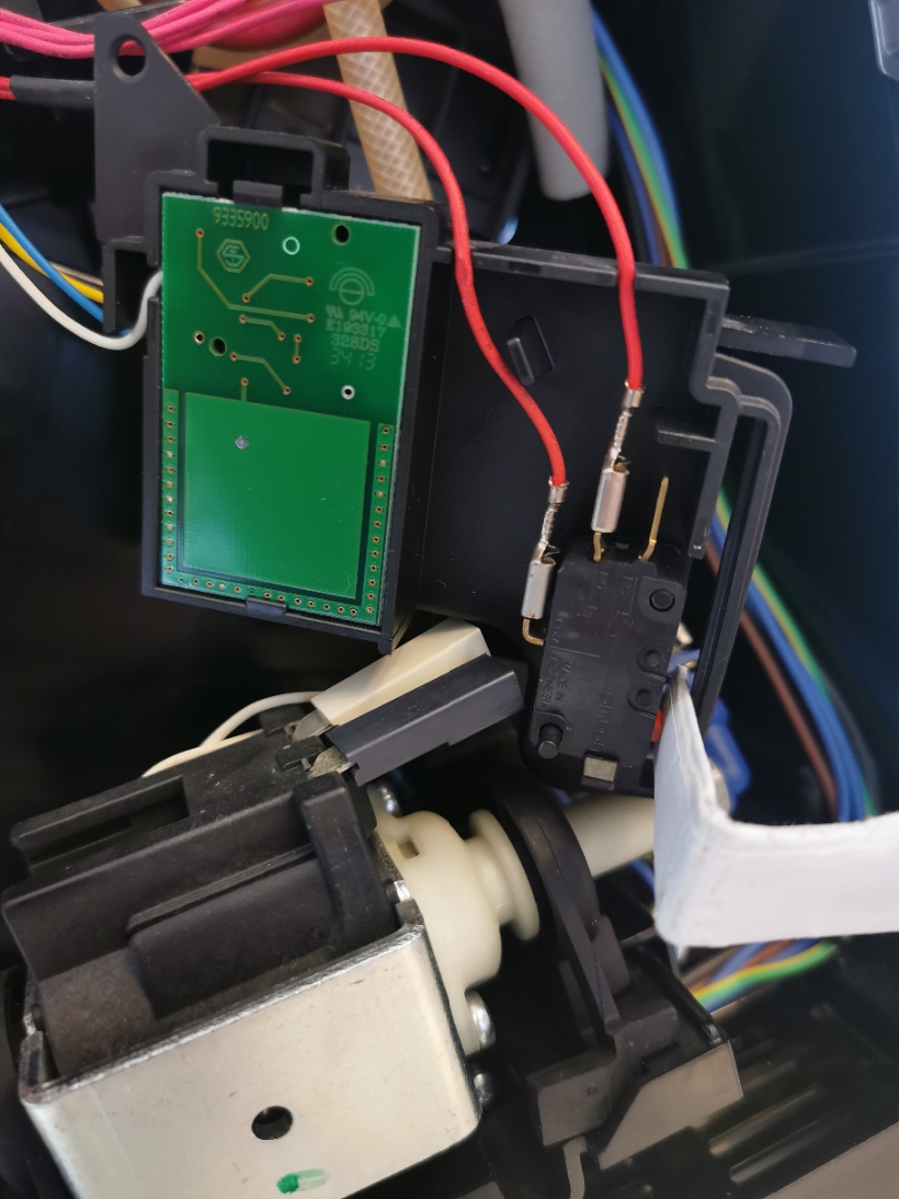

    • Hello, hold your hand in front of the water tank sensor and extend the hose that leads to the water tank with the hose for the milk froth and put this in the water tank. And bridge the micro switch for the right door and the drip tray. That's how it should work.
        364,36 kB, 1.094×820, 91 mal angesehen

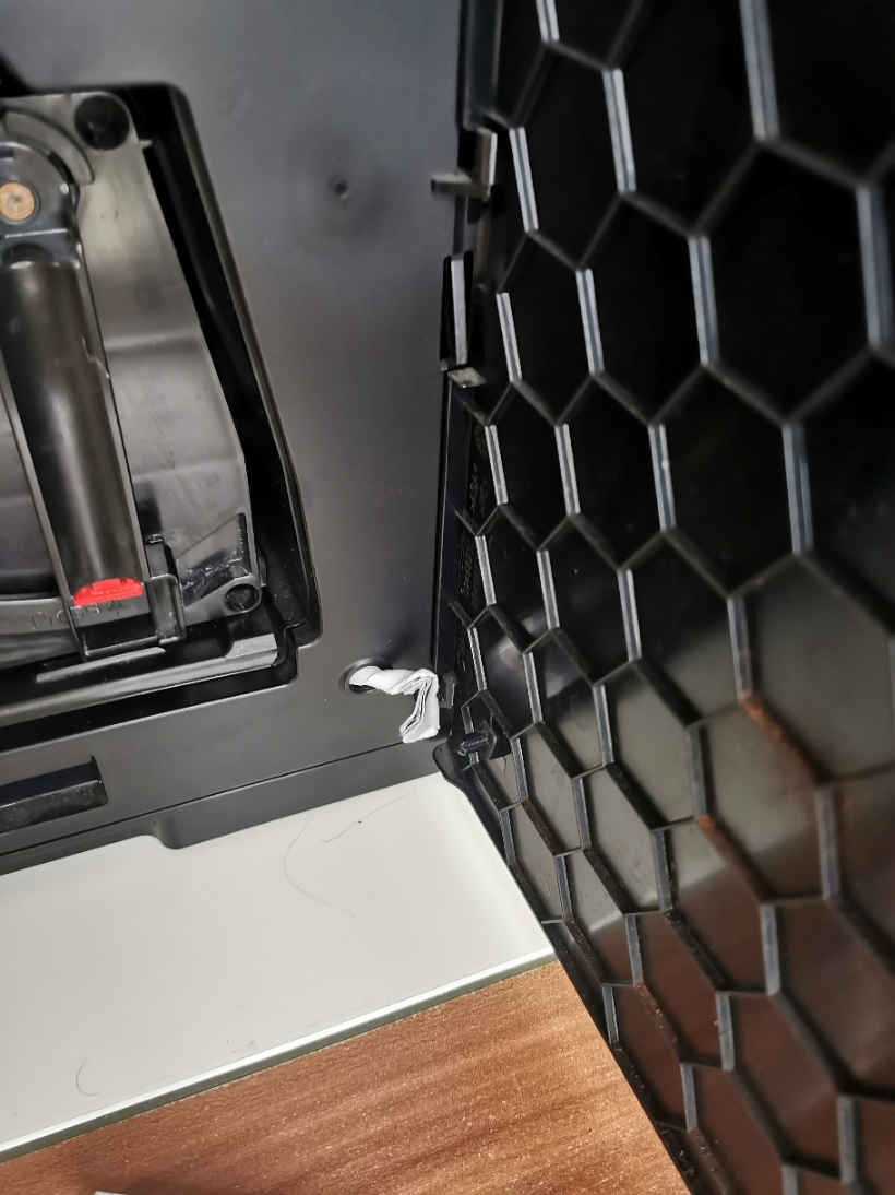

        479,86 kB, 820×1.094, 91 mal angesehen
