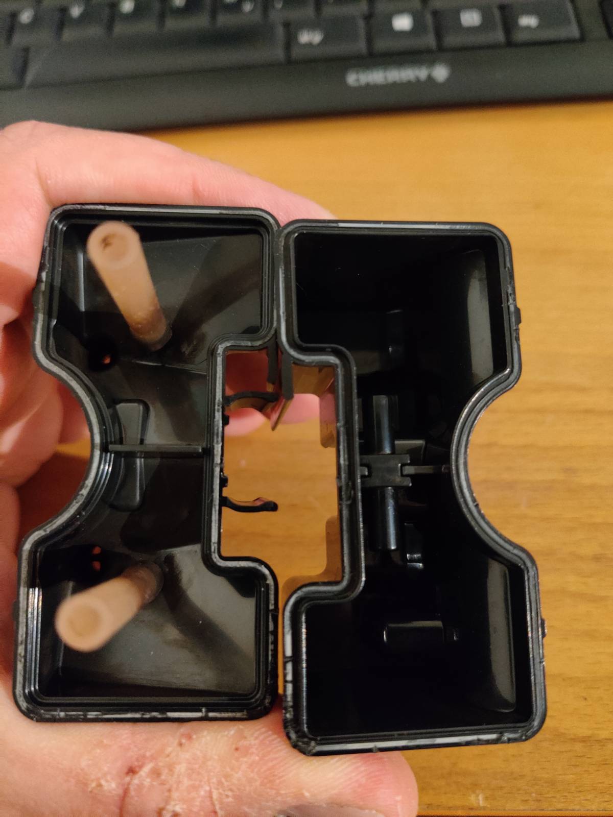

      Ref the uneven flow, the nozzle housing is blocked with old coffee mud so the coffee is coming through the overflow.
      Cleaning is most of the times pretty unsuccessful so I would recommend to replace it with a new part unless you have a very powerful ultrasonic cleaner.

      Btw, this is how it looks like inside.
