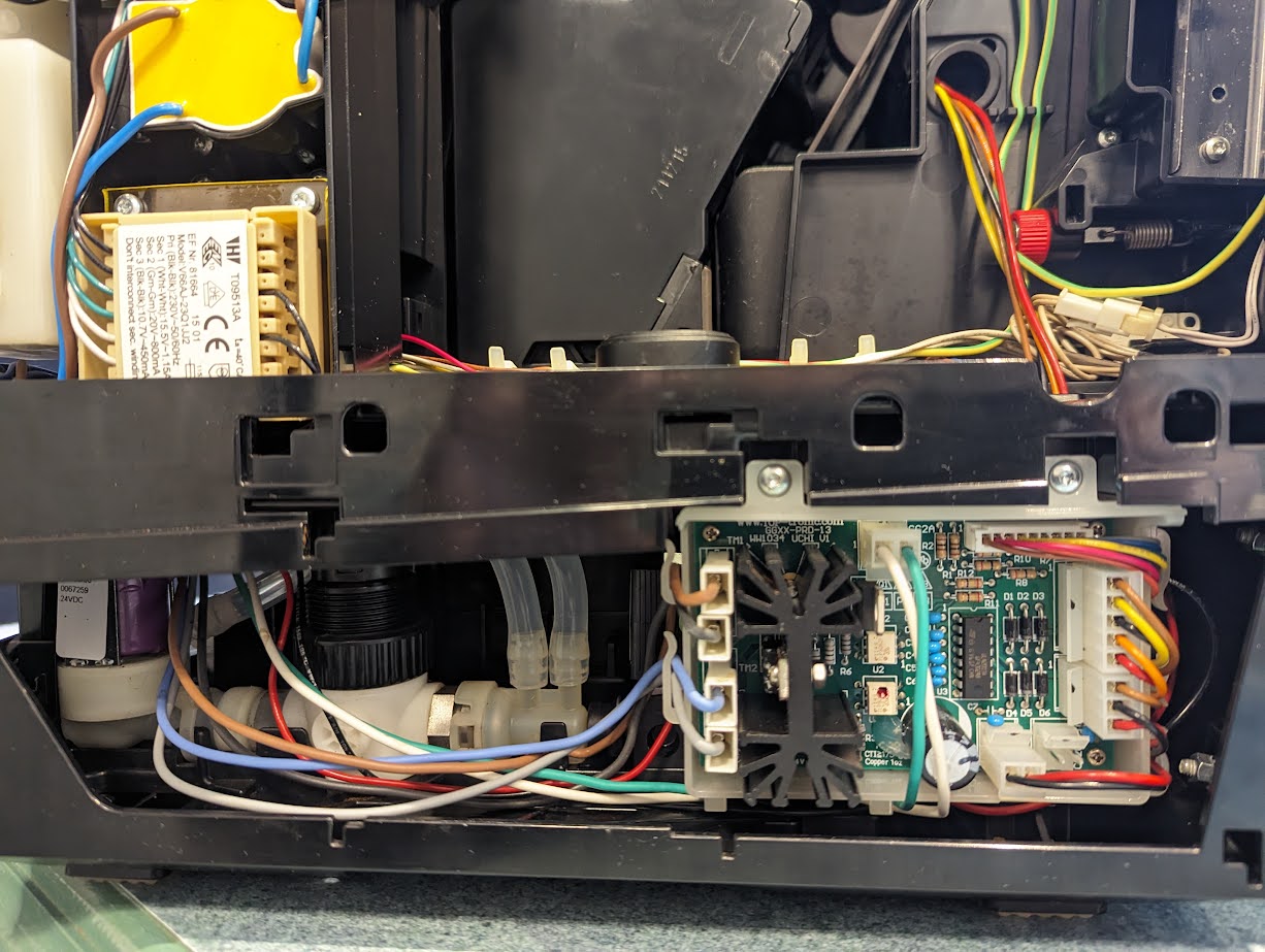

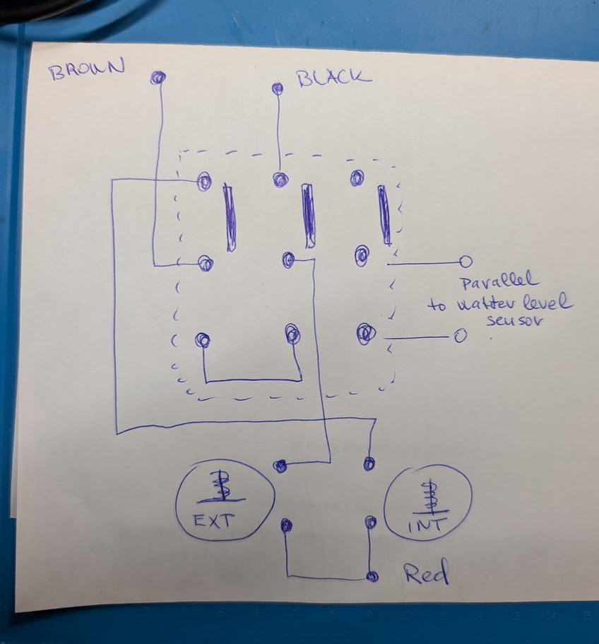

    • Just to update on this.
      I just finished modification of x8c that was configured from Jura to use only the tank and NOT the external water supply.

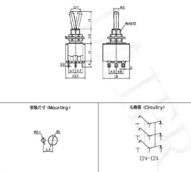

      Only parts needed to do this is one 3PDT ON-ON Toggle Switch
      Wire coding to the external intake selenoid valve is Black/Red (Red is common)
      Wire coding for the internal tank selenoid is Brown/Red (Red common)
      Use one bank on the switch to swap the Brown wire to the Black/Brown
      Other bank to disconnect the external intake selenoid from the black wire when connected to the brown control wire.
      Third bank to bypass the water level sensor when switch is in position Brown to black (Ext water intake)
      Interesting thing is that both selenoid are active only when there is pump running and even though they are 24V rated the actual voltage is only 9V.
      When you used this mod on machine that was configured to use internal tank make sure to flip the switch back to internal when descaling is requested.
