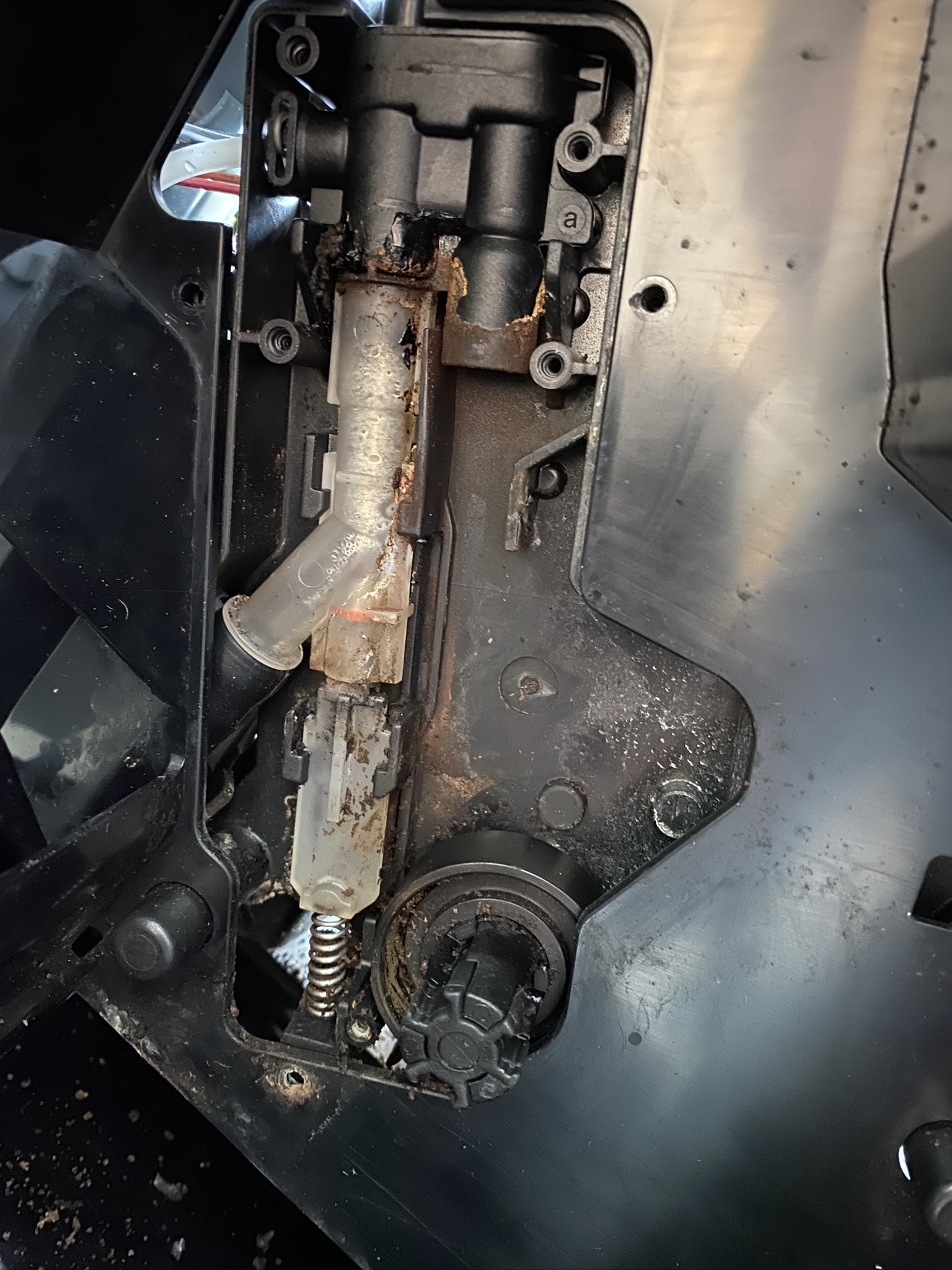

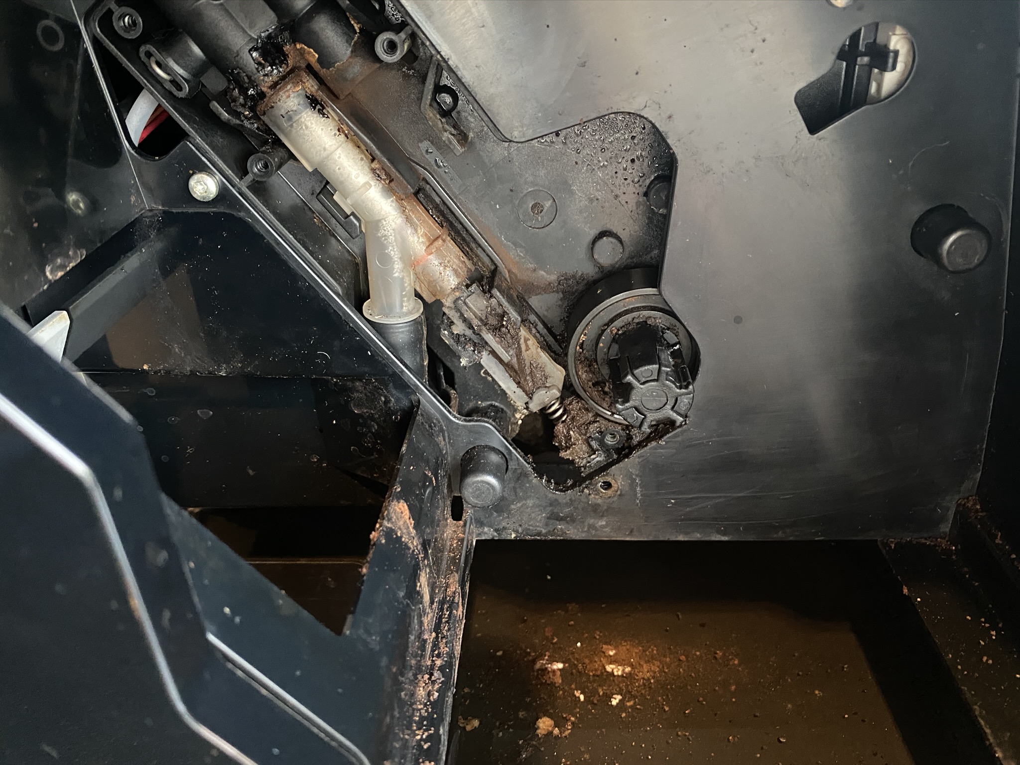

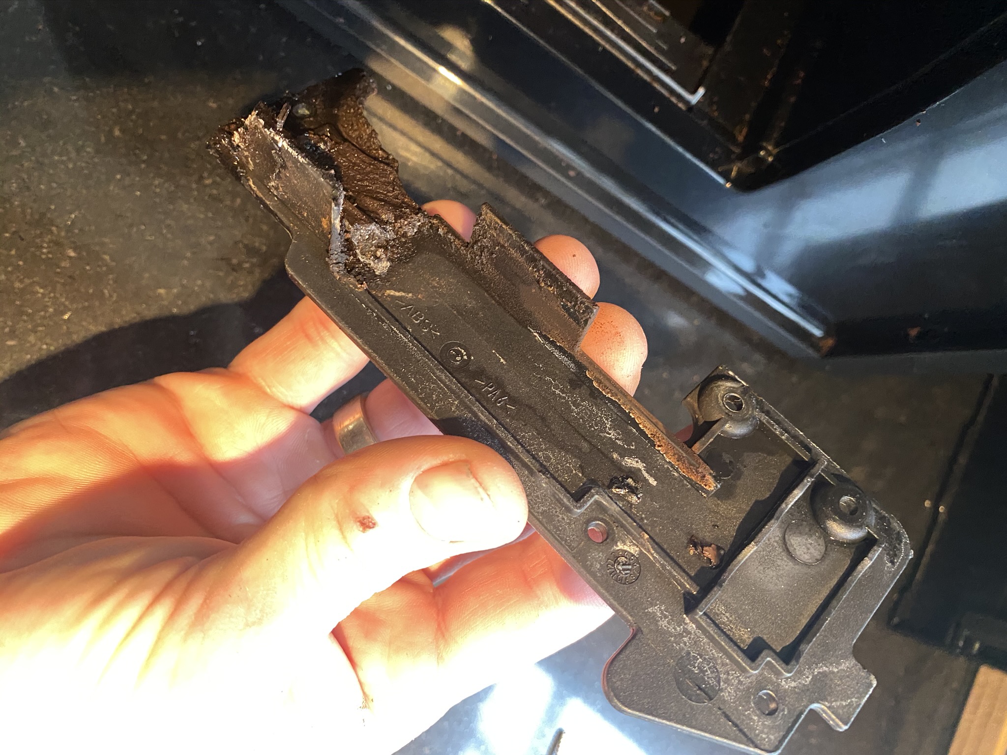

      As I just had some time before leaving for work, I took off the cap behind the brewing unit to uncover the drainage valve. As seen on the pictures, one of the screws was badly rusted, so was very hard to remove.
      Once the cover was off, there was a lot of old coffe around the drainage valve. I have removed most of it, but would be better to clean the whole valve.
        768,77 kB, 2.048×1.536, 737 mal angesehen
        721,2 kB, 2.048×1.536, 751 mal angesehen
        749,71 kB, 2.048×1.536, 771 mal angesehen

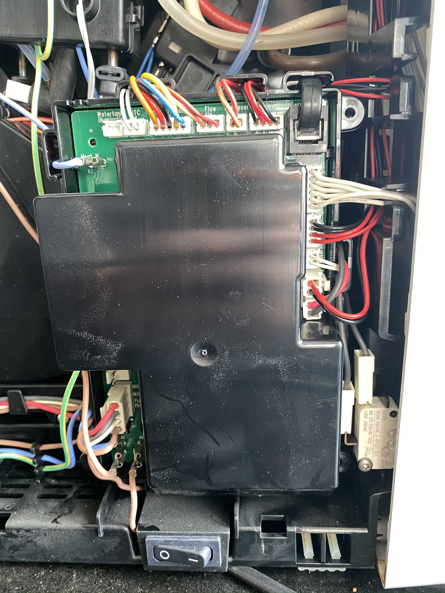

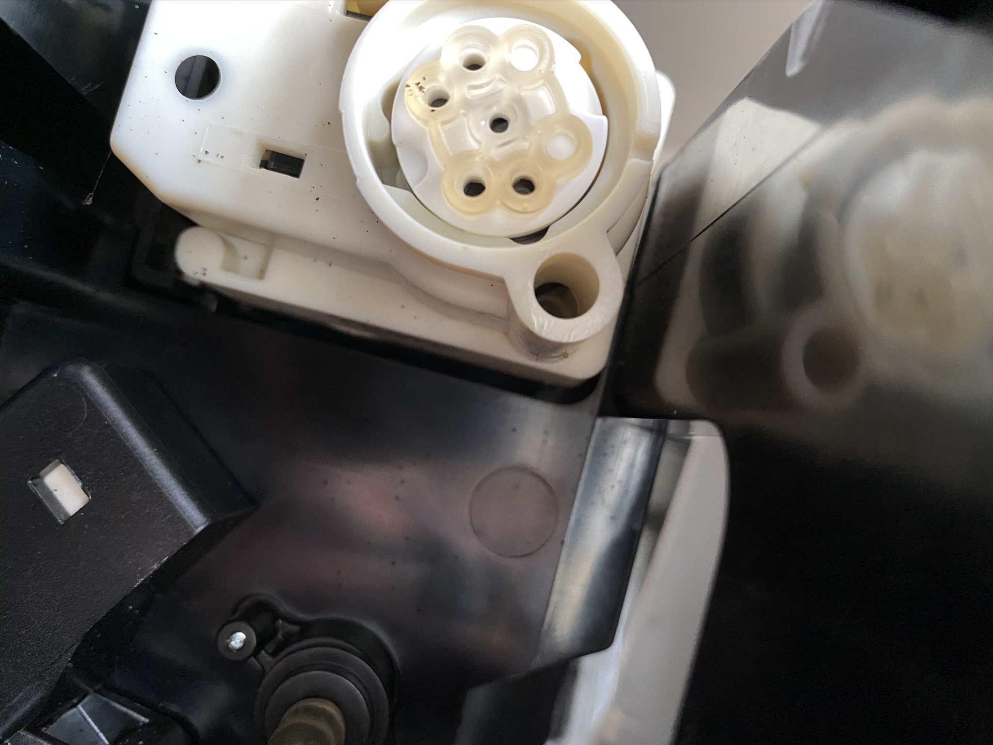

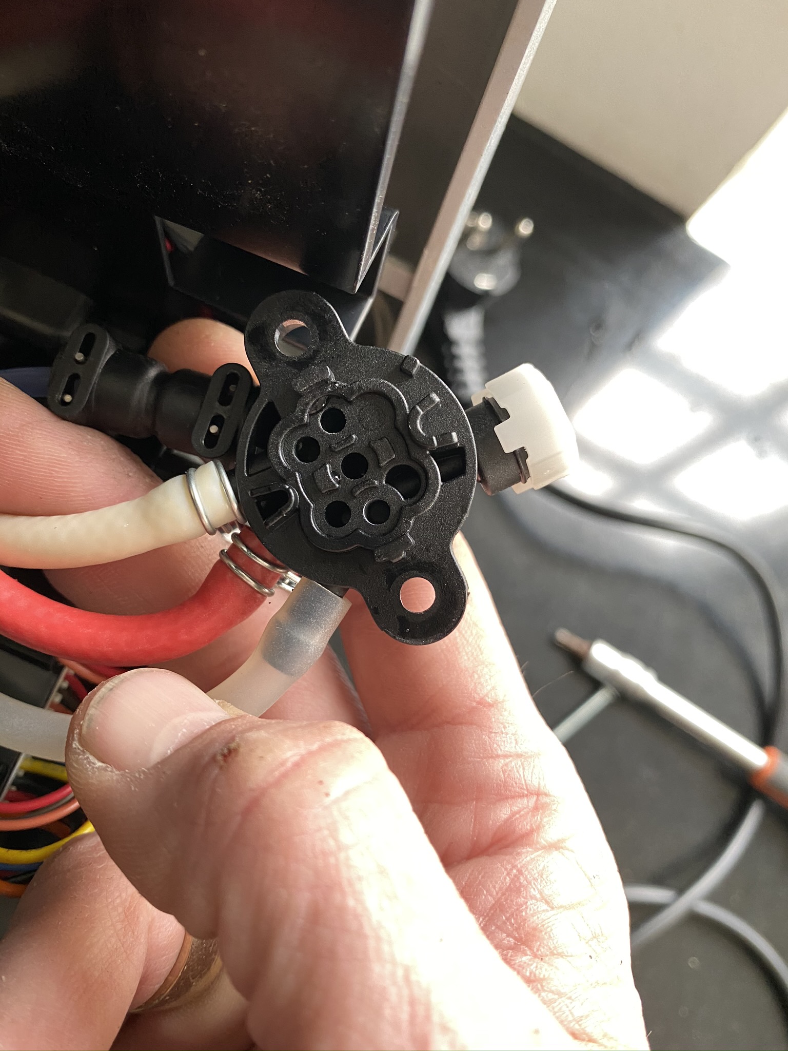

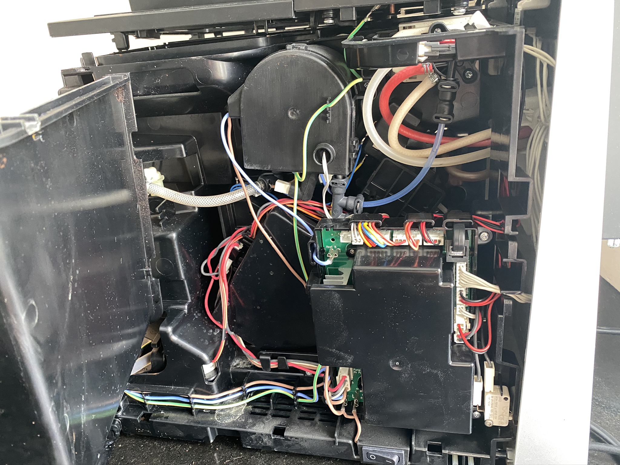

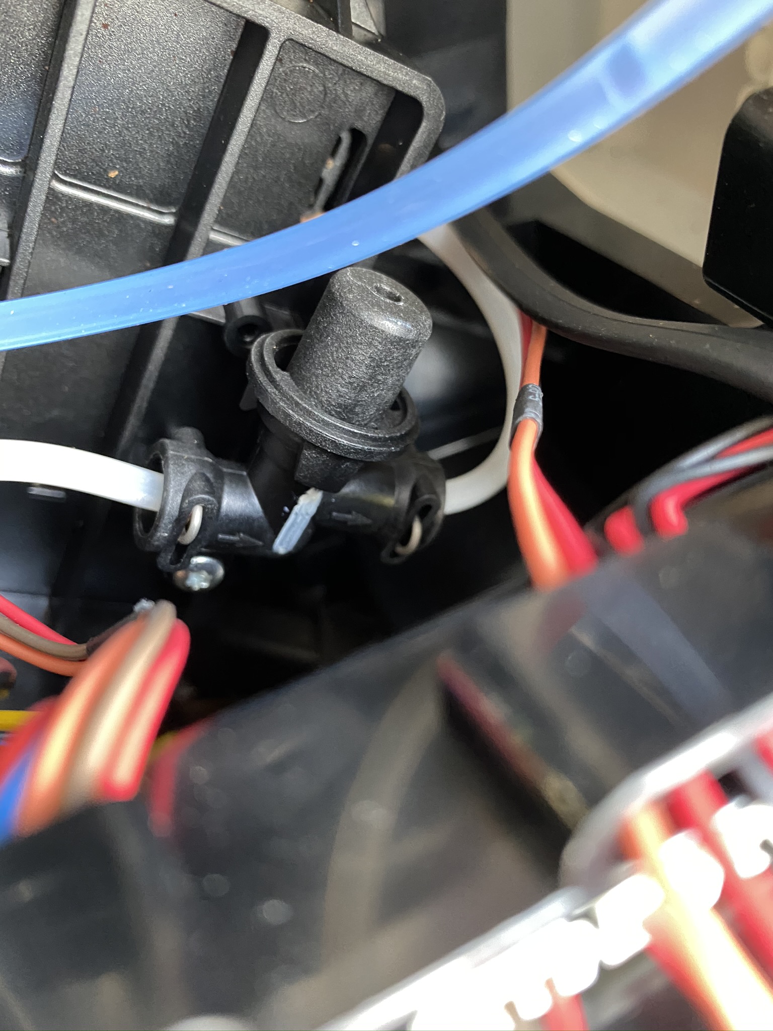

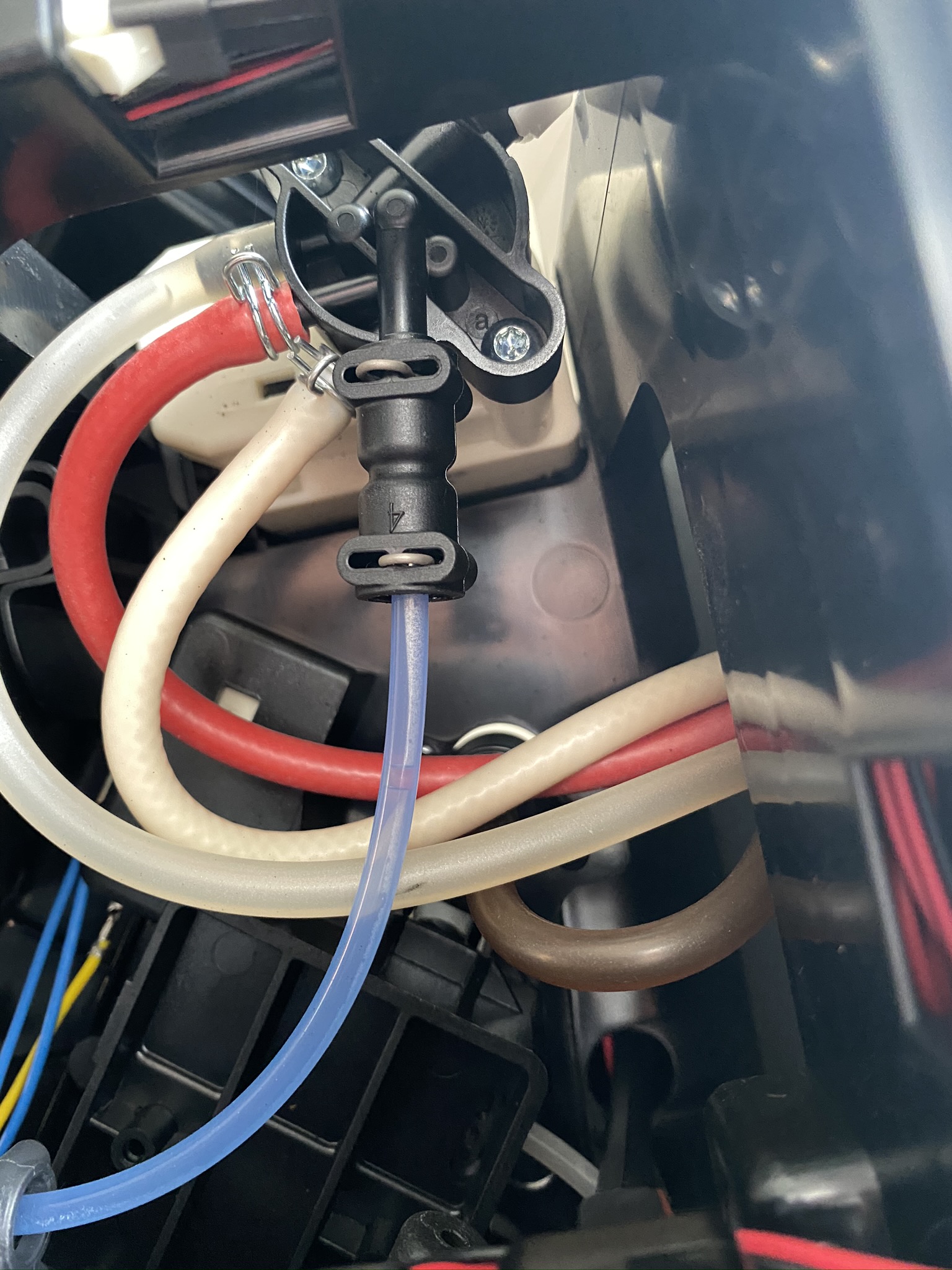

    • I have managed to disassemble the top and sides. If the black valve (IMG_2569) is the 'auslaufventil' - then it does not look worn or damaged. I have also unscrewed the ceramic valve which also looks nice and not calcified.
      Do I need to take all the wires off the PCB to get it off and get to the valve behind it, in order to unmount and clean it?
      How do I access and clean the drainage valve - it seems I need to get it out from the side with the PCB, which I guess means that I need to take almost all wires off the board?
      For me the most dirty component is the drainage valve, I would like to clean it if possible.

    • Correct, image 2569 shows the Auslaufventil (AV).
      Usually it's sufficient to just remove the screws from the PCB and move it slightly outboard.
      For the drain valve I would just unplug the connector of the drive (third from left on top on PCB) and split the red-black power cable of the drive. Disconnect the water hose left of the AV and remove the AV together with the drive after removing all screws from the brewing unit side.
      If you decide to remove the PCB completely, just a good advice: Take pictures! Better more than less.

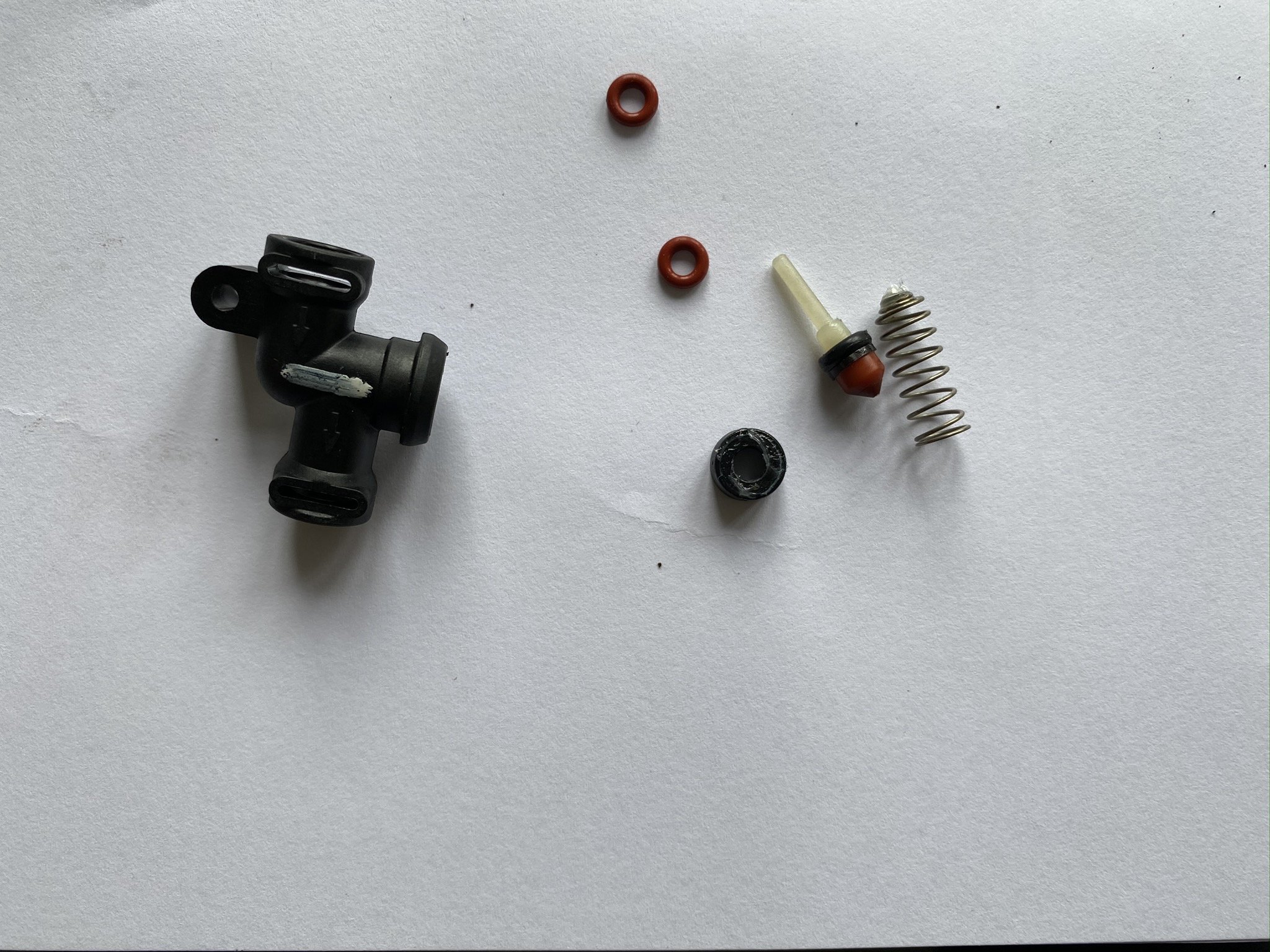

      So I took some of the cables off the PCB (made notes, but good point - images are very good in these situations! :) ), so that I could get to the AV and take it out. Looked very nice, but disassembled, cleaned and put new grease on the O-rings and the stud inside the valve. Reassembled again.
      I'll try your suggestion about the drain valve.

    • Before reassembling the AV, stretch the spring just slightly. Maybe 2 to 3 mm. Not too much as it might not open anymore.

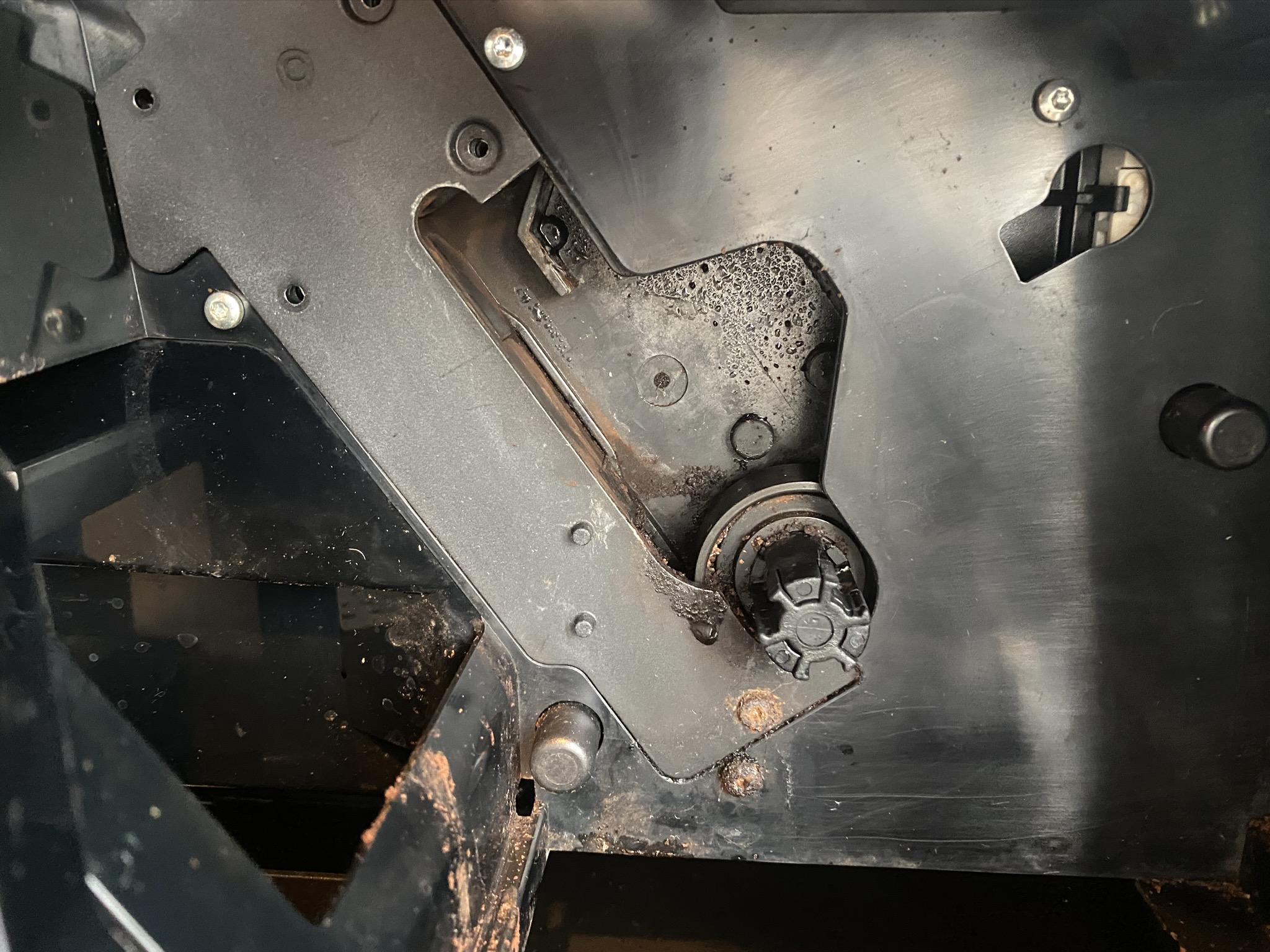

    • So - to sum up what I did:
      • Cleaned drainage valve, took it apart, new grease and reassembled (there was A LOT of old coffee grounds stuck to the surroundings)
      • Cleaned expansion chamber (the one connected to the drainage valve)
      • Took the AV apart, cleaned, stretched the spring a little bit, grease and reassembled
