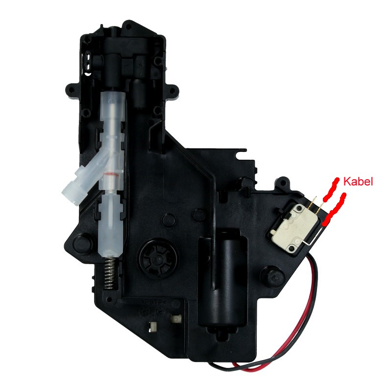

I have attempted to replace a defect Drainageventil on my Melitta CI. Afterwards I put the Mitnehmer in the wrong position and the machine made a noice and a system error 8.
Now I think I have put it in the right position and the system error is gone. How ever the brewing group is now causing problems.
When it is correctly inserted the machine says “insert brewing group”. And when I move the handle to unlock the brewing group the machine recognizes the brewing group and start running.
