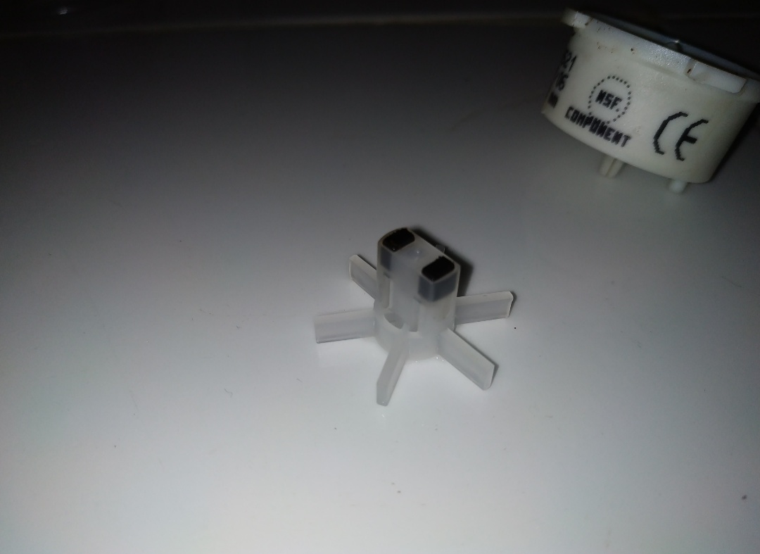

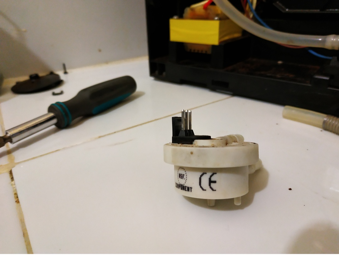

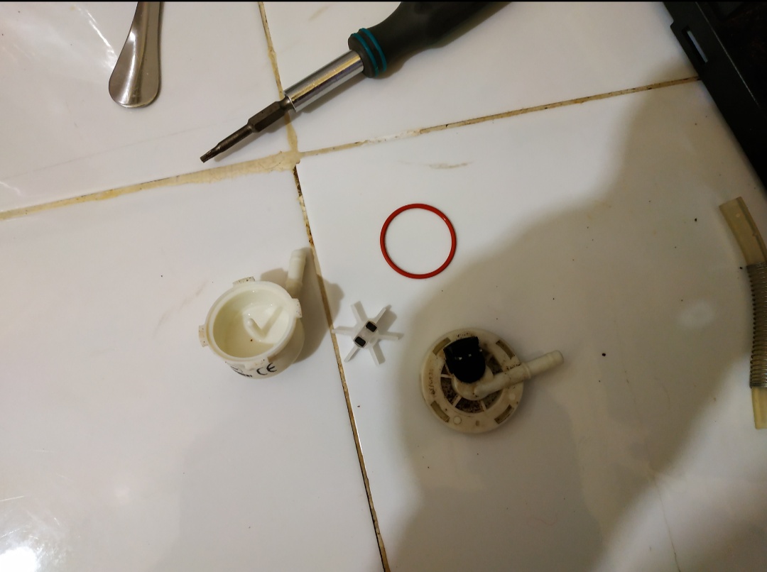

      I opened the flowmeter, clean it up but the problem still there ;(

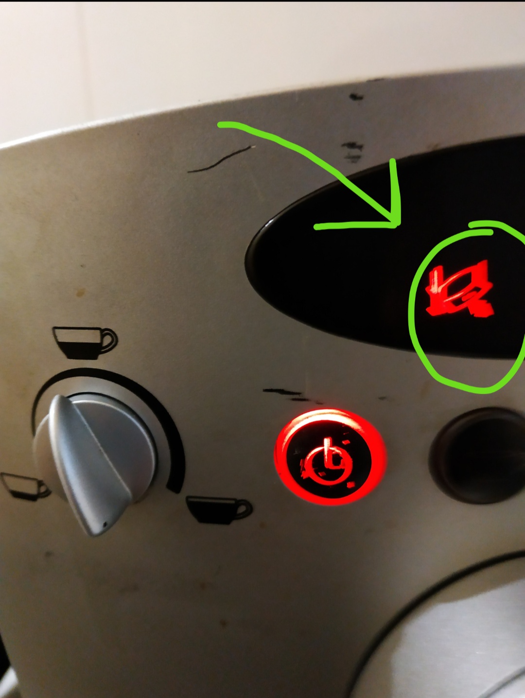

      At the same time i forgot to mention that the " drip tray" led is always flashing when i turn on the coffee machine, And I have to remove it and put it back. Same thing when i make a coffee, just at the end the led flash again. ( See the link below)
      ibb.co/cvoLkz

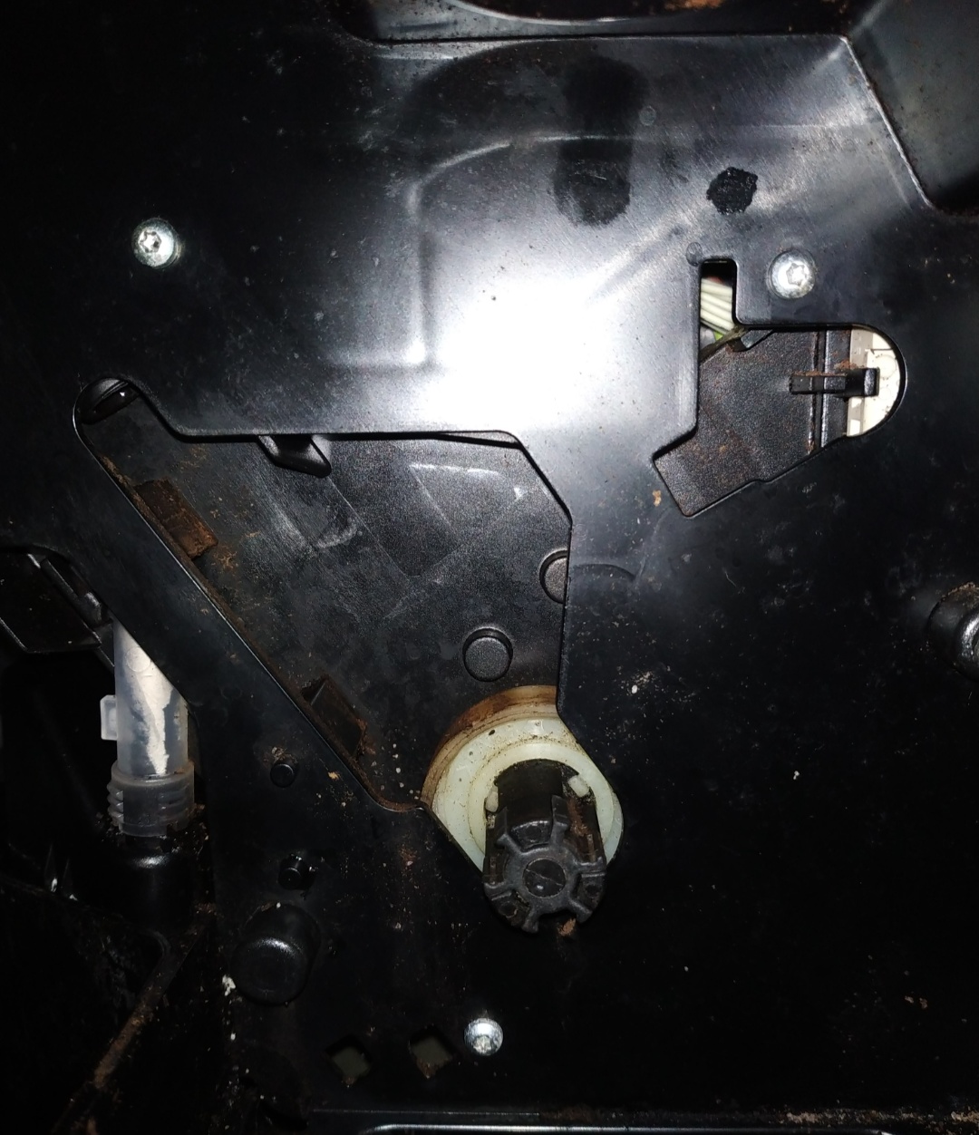

    • I removed all the parts of the brew unit and like you advise me i followed all the steps and figure out the motor turn too slow, like it hadn't enough power.
      But seems weird to me, yesterday all worked fine.
      Need i to change all the motor or is there a way to fix it ?
        345,54 kB, 1.080×1.252, 193 mal angesehen
    • Just to confirm the problem: Try to move the shaft by hand. Normally the shaft has a slight play and you should be able to rotate it just a little bit by hand.
      If it doesn't move at all, the shaft is stuck in the housing. This can be repaired by disassembling the drive completely and reworking the shaft by sanding it down a bit.
      Then the whole gear needs to be cleaned and slightly greased and re-assembled.
      If the shaft is free but still turns very slow, then the motor itself is worn out and the whole drive unit needs to be replaced. Or you find a good used motor and replace just the motor.
