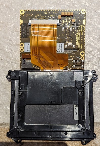

      I will probably open the display unit and see what's happening inside.
      It's unfortunate there is no connector on it so you have to unplug it from the main board and pull the cable all the way back.

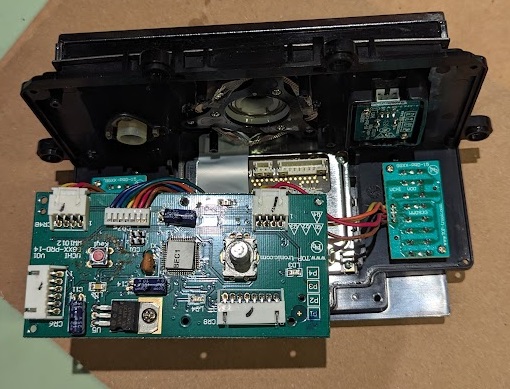

      It did clean up to perfection, I took it under a microscope and there is no damage to the board.
      Unfortunately problem persists. there is 3 LEDs creating the red light ring,
      the upper is fully bright and one on the left and bottom are only about 30% lit ( all slowly pulsing)
      No power button or program button light.
      My other "hope" was that water got in the SD card slot but when I opened the display module it looks untouched.
      The display is completely dead, not even backlight.

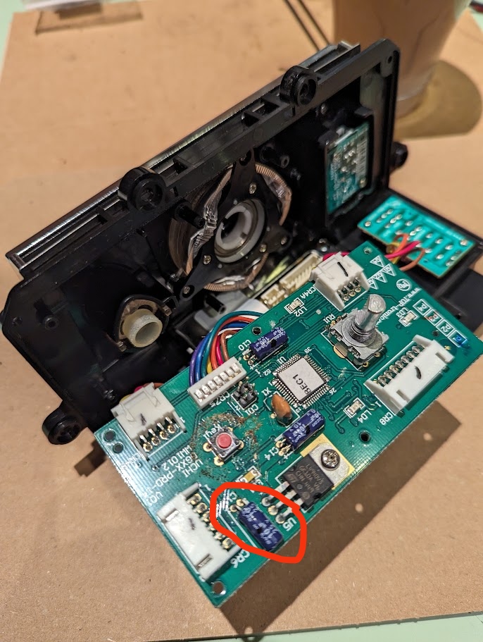

    • The marked Capacitor has 10uF the other ones have 100uF. I try to test the displays, measure the voltage at the 7805 regular.
      At one J5 Display the input and output voltage was ok, I soldered every via but it still strikes. You had luck, that it was easy to fix.

      Can you please send a picture showing the replaced part on the board?
      As marked in the picture by Tobias.L that's the right capacitor
      Yes, sometimes you get lucky! :)
      The linear voltage regulator L4940V5 circuit was the culprit.
      I got the idea from other project I work on fairly often, Z-wave dimmer switches by Jasco(GE) they fail for exactly the same reason.
      I fixed 100's of these. $55 device dead because of 5c capacitor.
      There is couple more things to do now, the left coffee spout LED is not lit (there is power all the way to the connector so I presume the wire to the LED or the LED itself. and slight drip by the ceramic valve after decalcification, probably cracked as usual.

    • Well, machine is assembled all back and running great, however there is new issue I need to resolve.
      On the rotating selector switch the rotary dial is very unreliable, you have to spin it very fast to get any response,
      and it jumps back and forth.
      The contacts must be oxidized perhaps because it wasn't used much.
      Rotating it for while improved the reliability but not nearly enough to live with it.
      Anyone tried to clean it, or should I just get replacement and replace it on the board?
      Thanks
    • The rotary no longer worked properly on my GIGA X3 with over 130,000 beverage preparations. You can do whatever you want - it will only help in the long run to replace it.
      Since I'm not much of a soldering expert, I let Tobias do it. So I can't say whether there was anything special to consider. In general, rotaries tend to break and need to be replaced.
