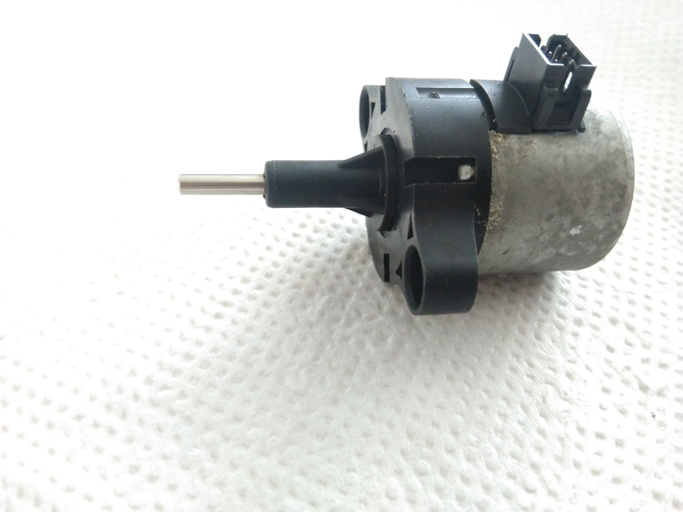

I would like to ask about the issue I currently suffer. My ENA Micro 9 stopped with initial rinsing some months ago but it still made a coffee so I did not take a care.
Unfortunately now no coffee comes from the spout, the garbage tray collects only water and milled beans. I am still getting hot water from water spout.

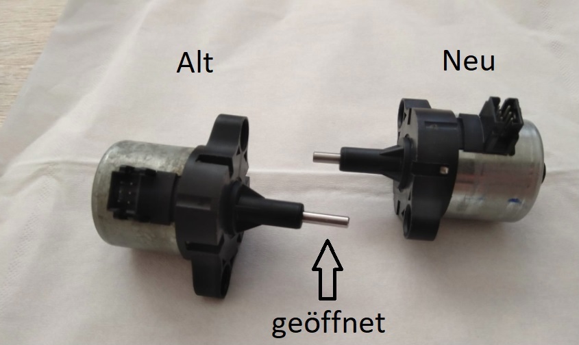

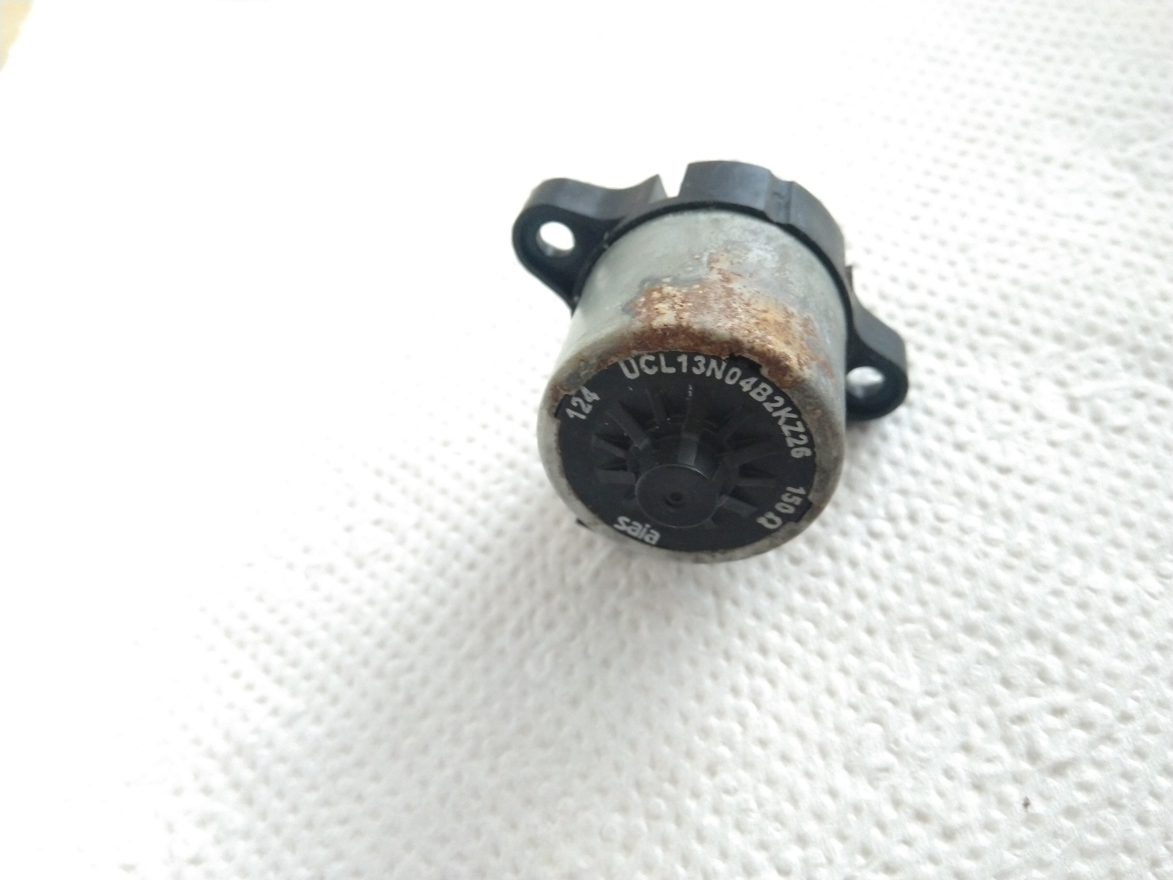

I looked for possible issues and thanks to Komtra, I ordered new Drainageventil, but it made no difference.
I believe someone could already experience this issue. Thank you for your hints!
