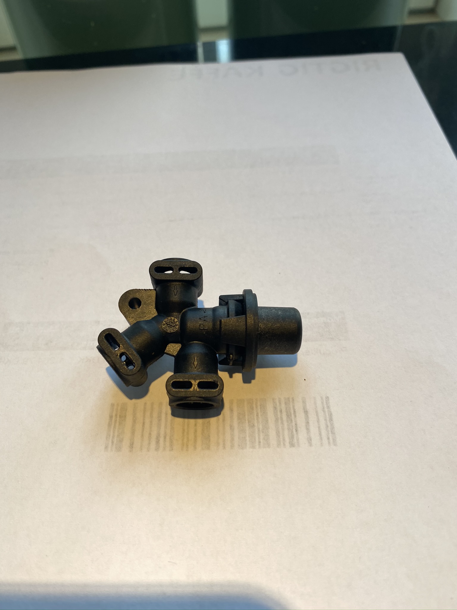

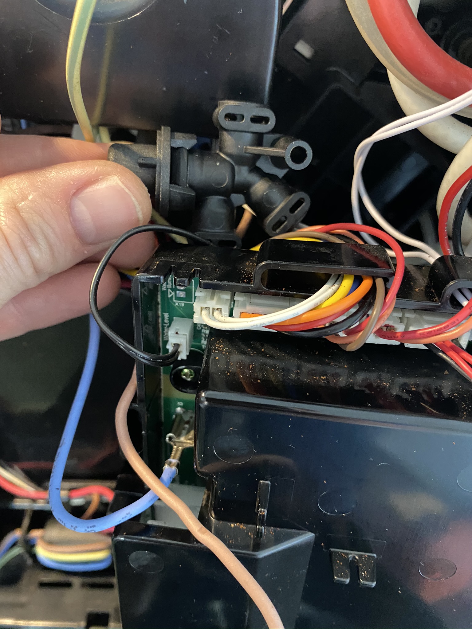

    • Ok, first problem: I forgot how the AV was assembled in the machine :S
      Can anyone help? There are two arrows, in and out - I guess the IN arrow must be attached to the heater and according to the hoses the most likely placement is with the valve to the left?
      Actually it was not mounted with any screws. Is that normal?
        408,04 kB, 1.536×2.048, 249 mal angesehen
        693,72 kB, 1.536×2.048, 247 mal angesehen
